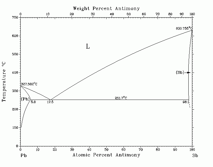

D... to get extra heat to melt the pure antinomy, but I think is like many alloys - melt temp get LOWER than the constituents - is actually a "eutectic" temp in some alloys that is lower melting temp than any of the parent metals used to make that alloy.
The Pb-Sb definitely has a eutectic, it is that point (at 17.5 atomic%) in the diagram I posted where the melting point lines dip down to 251.7°C. FYI, 17.5% atomic% antimony equals 37 weight%.
