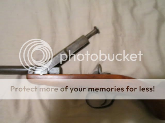

The gem in question is a little deutsche werke erfurt I had hoped my young'un would be able to shoot. I was beginning to believe he would outgrow it before anyone could squeeze it's trigger. Now, it's good to go, and the weekend has a ray of joy to offer.
the gem
The new bolt installed

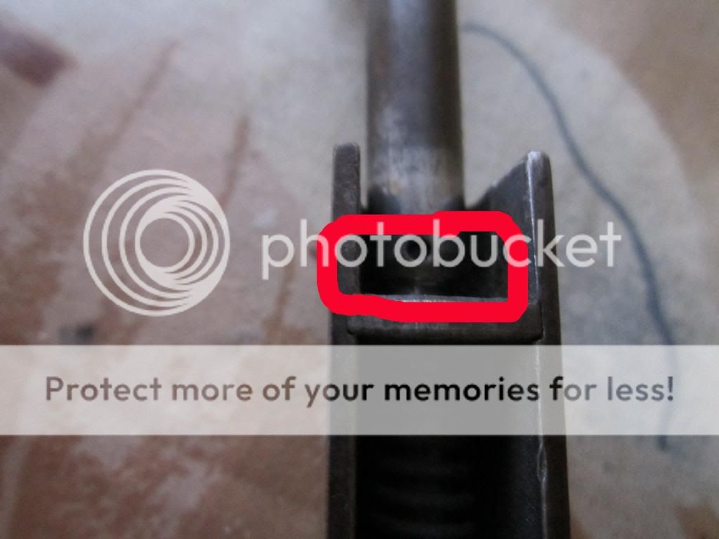

The old bolt. Terrible picture, but at the bottom of the handle it was rounded. I'm guessing some "folk smith" thought it could reduce trigger pull. It actually made it so the sear wouldn't engage at all. A very dangerous condition!
