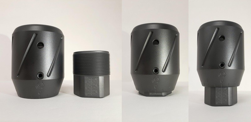

Spearhead Machine is founded by the Chou brothers, and we are proud to introduce the Spearhead barrel tuner.
Please note Tuner does not accept any additional muzzle devices.
Designed to be heavy to tune the thickest and heaviest barrel with ease. Barrel tuner can be used for centerfire or rimfire.
Excellent balance for your rimfire PRS/NRL or positional shooting rifle – With the importance and trend of adding weights to rifles for balance. Our tuner puts the weight right where it matters, at the muzzle. Heavier tuner can add optimal balance to a thinner or shorter profile barrel. This is especially significant on shorter rimfire barrels where the rifle tends to be butt heavy.
Reduce group size – Tuners have been proven to change barrel harmonics. By adjusting the tuner, it can assist the barrel to find a more accurate/stable node. Makes a good load even better. Improve accuracy especially when shooting factory ammunition

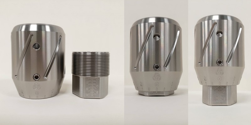

User friendly – Scale machined on 3 sides, easily reference your tuners index marks. Nylon tip set screws provide easy setting of graduations between shots. No more loosening of set screws and retightening between shots. Less time tuning = more time for yourself. Nylon tip set screws will not damage adapter threads.

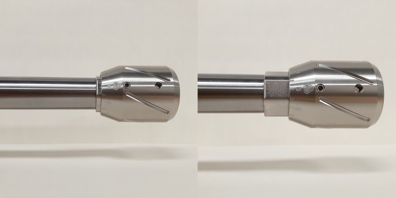

Quick and easy install – No gunsmith install or modification is necessary. Just screw on the adapter to existing muzzle threads and tighten with a wrench. Screw on tuner to desired position and lightly snug set screws.
Heavier tuner – With most match barrels being larger/heavier contour. Our tuner will be able to tune even the heaviest contour barrels with ease. Heavier tuners will find the optimal node within a revolution or 2. No more wondering if the tuner will work or not.

Specifications
Adapter weighs 118g / 4.162oz
Adapter diameter across hex points 1.070″
Adapter diameter across hex flats .995″
Tuner body weighs 224g / 7.901oz with set screws.
Tuner body diameter 1.6″
Length of Tuner assembly on short 0 2.105″, on long 0 2.550″
Total weight of Tuner with Adapter 342g / 12.063oz
Material: 303 stainless steel for exceptional corrosion resistance and strength, black nitride finish.

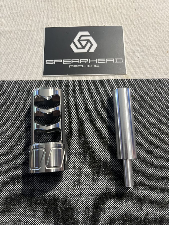

So I'm now testing the Spearhead Brake/Tuner combo. Test rifle is a Savage Axis II Precision in .243, pretty much an entry level rifle for competition. To date, I've had no issues with how accurate this rifle has been. I've initially been shooting with a Spearhead 4 port self timing brake on this rifle and can't say enough about the great quality products that Kevin and Will produce. So when the brake/tuner combo arrived, I decided I'd undertake some initial testing on my .243. I'm shooting hand loads using Hornady 105 gr A-Max bullets set into Federal cases. Our 100 yard range berm with meter target is 96m so that is the distance all of my rounds have been fired at.
