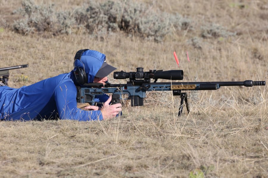

I ran the 5 port tuner brake this year on my 6mm BRA - see attached photo.
I also ran the 5 port without tuner on my 6.5x47L NRL Hunter rifle this year. In 2024 I was able to run it with the tuner, but this year I upgraded to the triple-pull bipod which is heavy so I had to cut the tuner weight out.
