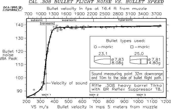

This chart shows how the sonic crack is generated over a range of velocity. If you want relibaly subsonic ammo you need to shoot for about 1000 fps or slightly less.
