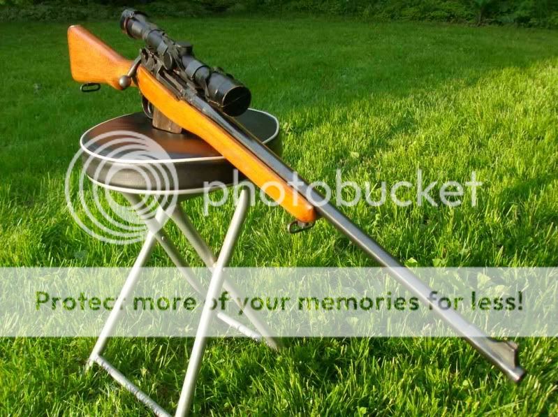

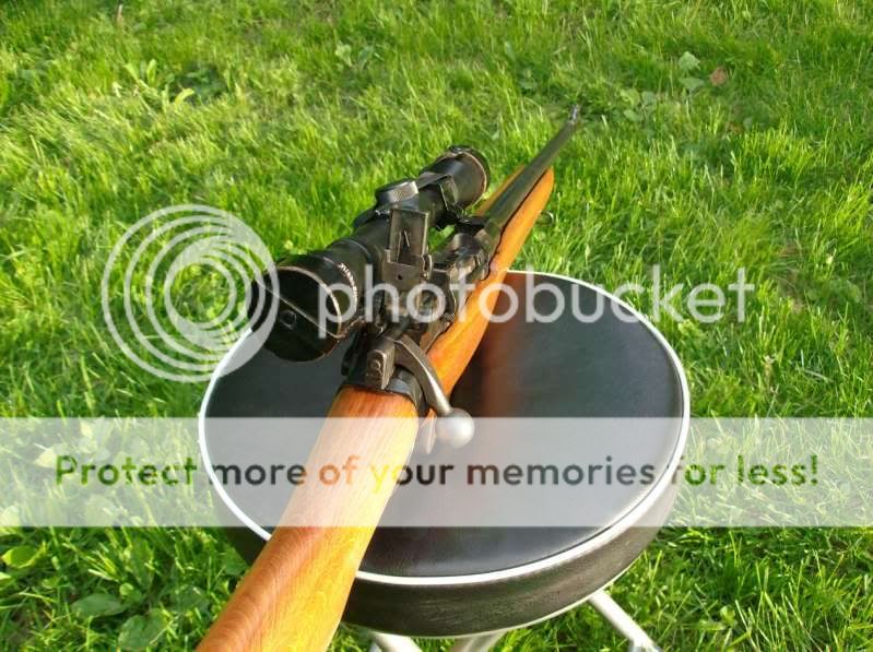

I refurbed this No4Mk2 Lee Enfield (bought from Whylook, thanks!). It needed some care, but I think it now looks decent. I haven't taken the time to sight it in yet.
The scope mount on it is from Weaver and allows the scope to pivot to the left side, allowing use of the iron sights.
I am not a scope and scope mount guy, so I have no idea how good - or not - this type of mount is at holding zero? (see pics below)
Thanks!
Lou

The pivot mounts work good when they are new, however when they wear they tend to shake loose. On the front of the front base there should be a big flat screw that you will be able to cinch it up tight.
I had one set on a old .303 much like yours, I reversed the front base and that solved that lil problem.
Thanks 303c. Everything is currently pretty snug so I'll give this a shot at sighting it in, and see how it goes. One more reason to go to the range :)
