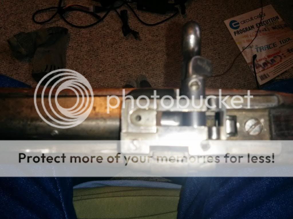

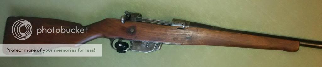

I picked up this Ross rifle at the Kamloops gunshow the other day. I have a thing for straight-pulls, so when I saw this at an attractive price, I couldn't resist.

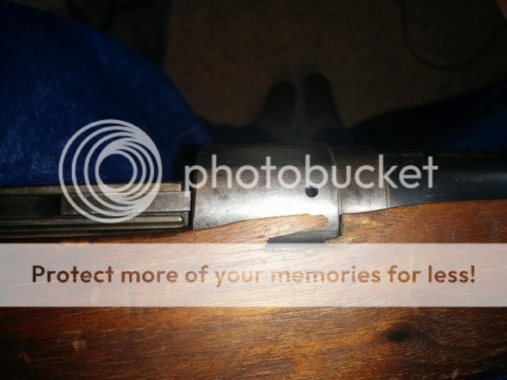

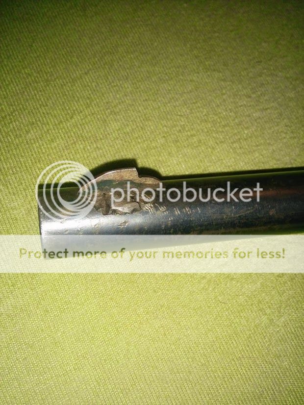

Yuck. The ladder sight was taken off and a piece of spring metal wedged and soldered in there to form a rudimentary buckhorn sight. The front sight is loose, and all around it is chewed up from someone trying to keep it on. The stripper clip tangs were ground off, and the barrel hacksawed to around 21 1/4". For some reason, it does not have a serial number anywhere, and the stock was oversanded. some markings left on the stock indicate a date of 1916. Probably the only things going for it is so far is the bolt has the "Pin mod", the barrel rifling is very clean, and the action is undamaged and appears mechanically sound.
I have done a little research on Ross rifles, and know enough about them to feel confident it's not going to murder me in my sleep. What I would like is some input on what should I do. Restoring it would be an really expensive endevour, considering I would have to rebarrel it and find all the parts, but possible if I span it over a few years.
Right now, I'm leaning towards improving what I have, and turning it into a decent hunting rifle - clean up the finish, replace the stock, and mount a scope.

Probably be your best bet overall. Ross rifles are not economical to restore, and to do so one must start with an uncut specimen. However, Ross Rifles are fantastic rifles as they are rugged and very well made. Seeing as you rear bridge is already butchered, taking it to a welding shop to have the spring slot filled in would be your best bet. Once that is done, either adapt or custom make a scope base(s) or rail to bridge the bridge and the front receiver ring. A rebarrel will be your best bet if you reload, as most chambers were enlarged at some point, but if you're thrifty, you could simply have the barrel set back a thread or two and re-cut the chamber to minimum spec.

Thanks guys. For the scope, the receiver profile looks close enough to a SMLE Mk 3 that I think I could modify a Weaver TO-10 base to fit (Though I hate the thought of ruining the front band markings)
I'll have to fire a few rounds off to find out about the condition of the chamber. The fact the finish on the barrel is different than the rest of the action has me scratching my head a little. It could be the seller was looking for markings on the reciever with sandpaper or steel wool, but I keep having this thought the barrel was changed out. Since there is no crown on the barrel, and the hacksaw job was not very straight, I figure I'll trim the mess of a front sight off when I re-crown the barrel. I could perhaps fill it in with weld, but the heat could affect the barrel's metallurgy.

You could do very beautiful things with that one very easily. When it's chucked up in your lathe for the re crown simply turn that sight off and clean up the profile. Easy peasy and the front of the barrel is clean and tidy to compliment your scope job. A nice rust blue and a replacement stock (rumor has it they WILL be available soon!) and you have a beauty to treasure.

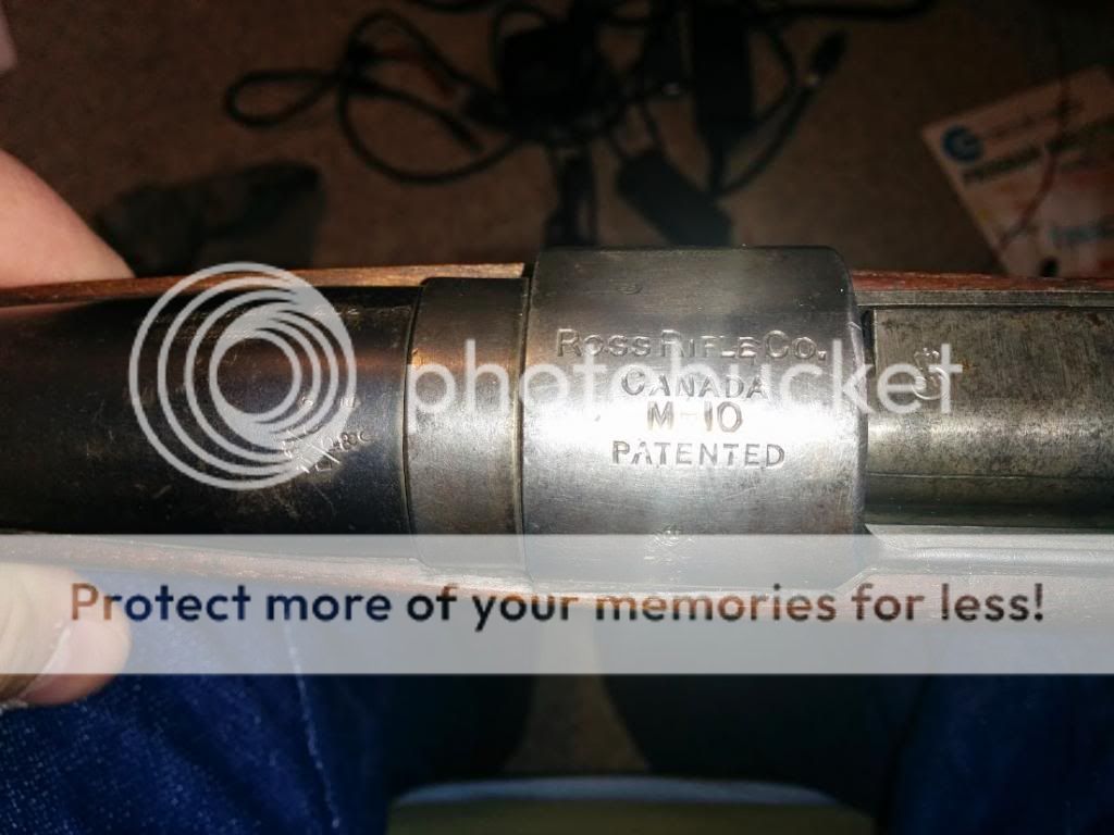

Also, add to the positive points that your rifle has been proofed at Birmingham Proof House. The "BM-Crown" on the bolt carrier and the ".303 - Nitro Proof" on the right side of the barrel shows this.

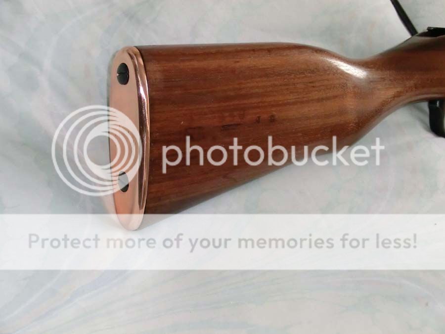

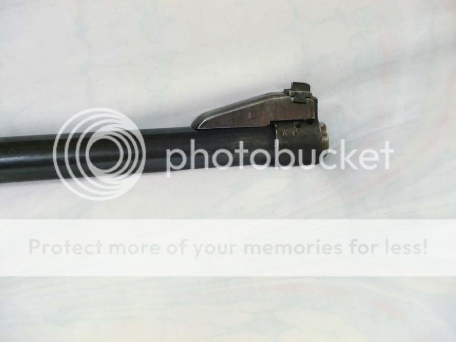

I had a very badly butchered 1910 Ross. The barrel had been cut with a hacksaw just below the front sight. The rest of the metal was scraped, scratched and filed. I cut the barrel back to clean it up then took a bit off the od and installed a #4 front sight band. I topped that with a sporter ramp sleeve. I polished the barrel and receiver, cold blued it and left it. After redoing the stock and making a copper butt plate, I have what I would call a beautifull sporter. You can do anything with these things.

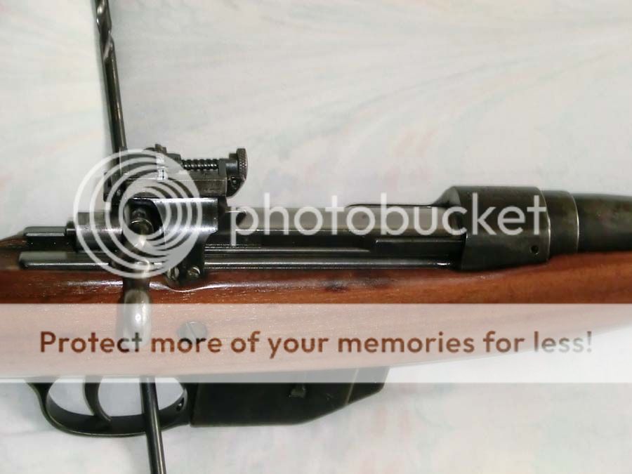

Here's my Ross, with a 4-12 Vortex Diamondback on it. I bought it with the bases already on, and just added the Diamondback and a set of Weaver Grand Slam rings.
Shoots wonderfully, though the scope is giving me grief since I apparently suck at mounting scopes...

Here's my 1910. I polished the bolt to a mirrror shine. It doesn't show that well in the photos. Note the #4 front sight. I carved the stock down to make it slimmer and left the colout natural to show off the grain.
I left the original rear sight because I like the look. I may have to scope it though because my eyes just don't work that well anymore.

I did not take any pictures of them, but on both the barrel and receiver ring is the stamp "Not British Made"
That probably explains the proofmarks, but not the hack job on the sights and barrel. I guess if it was a longer barrel model?
