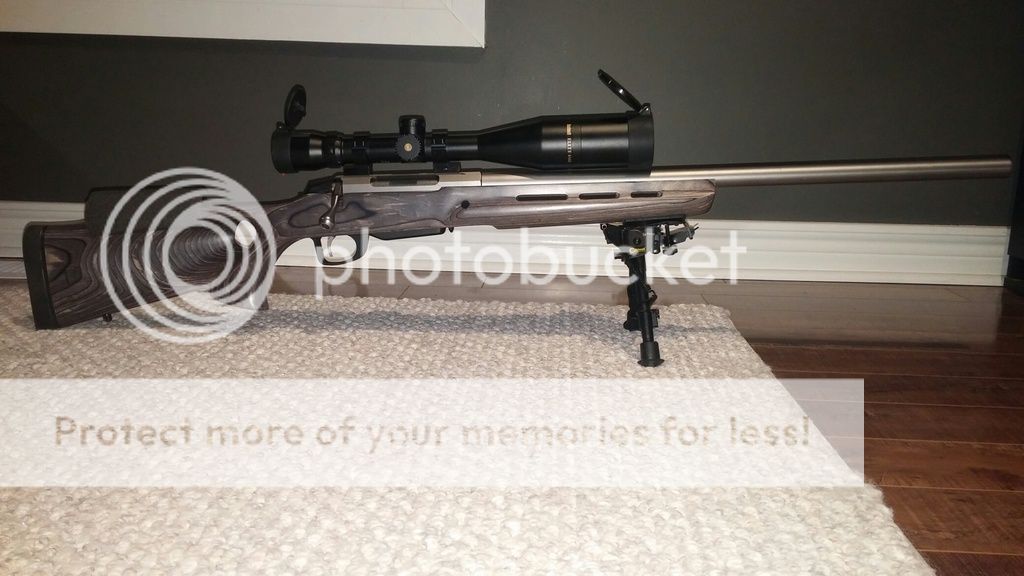

You may also want to consider a Boyd's, here's a pic of the 1st Tikka I bought last year in 300 wsm. The stock cost around $250 after shipping and exchange rate, I also had to get bottom metal which was around $180 - $200. You'll need to bed it if you go this route but this gun also shoots nice tight groups without much effort
