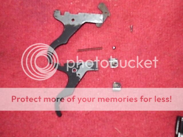

In my experience, do not take it apart !!
There is a goofy procedure to get the trigger set again, and trigger parts are rare if something breaks.
All other parts can be found.

I've owned a few of these gems (both 20's, and an m16R). Very similar to the current jw-14 by norinco. The trigger housing/mag well is robust the trigger itself is quite fragile.

Someone must have been pretty rough with their gun to break the trigger off like that. I had a few of them and nothing ever broke.
Dunno how it broke exactly, it came to me that way. I do suspect ham-fisted tinkering... I had never had to work on a 20 prior. I ended up not only finding a trigger for the original project, but fixing a 16R (too nice to just steal the trigger from), and building a complete 20 from leftover parts. The actual trigger is robust enough to sling tens of thousands of rounds. They are not designed for tinkers!

During the odyssey fixing the first project, I found quite a few other "parts guns" that required the very same part to be complete.
