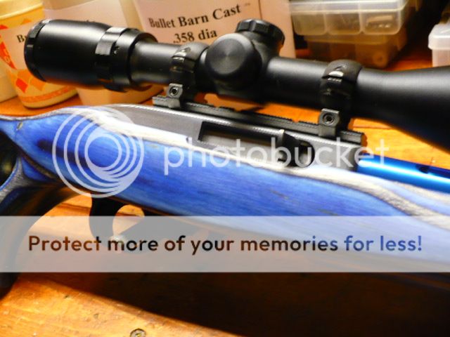

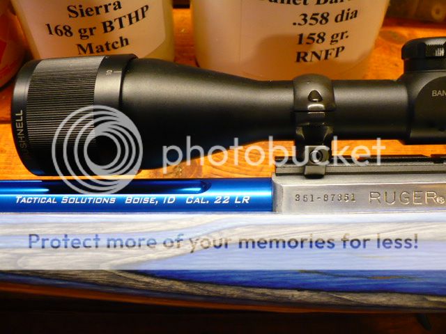

I just finished putting a 10/22 together.
Blue Boyds thumbhole stock, blue Tac-Sol barrel. I used Aircraft stripper to remove the factory "crinkle" finish on the receiver. About 1 hour to sand the machining marks out of the receiver (started with 220 grit, finished with 600 grit). 20 minutes with some aluminum mag wheel polish and it looks OK now
