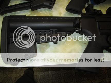

Its an easy fix. In the hole that the red arrow points to, there is a split pin (roll pin) inserted into the blind hole.
This hole does not go all the way through the stock on the other side on purpose. Its designed to infuriate those who wish to just punch it out. No matter. You need to get a very tiny drill that will fit inside the roll pin. We are talking a number drill like a #57-#60. In a dremel tool or a pin vice, drill through the other side of the plastic stock to give yourself a location point. Flip the stock over and use that point to drill down to the roll pin with a drill the same size as the roll pin (1/16" if I remember correctly). Go easy because the roll pin is almost as hard as the drill and will catch on it if you press too hard. Now you have a clear hole running through that you take a 1/16" punch or a 1/16" drill bit and drive that roll pin out with a few taps with a hammer.
You may try using a red hot pin to push through the roll pin and the opposite side of the stock if you don't have a tiny number drill that fits inside it. You may also just find the rough location on the opposite side of the stock and try drilling down to the roll pin with a larger drill...this will leave a bigger ugly hole, or several of them if you miss.

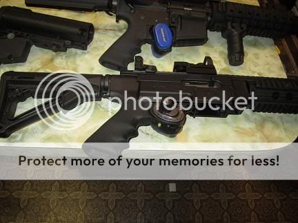

Once your done removing the roll pin, you need to drill and tap some 1/4X20 holes along the square spine under the tube for new locations of the bolt that locks it. I put only one on mine...looks like this.
