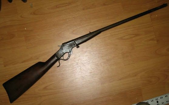

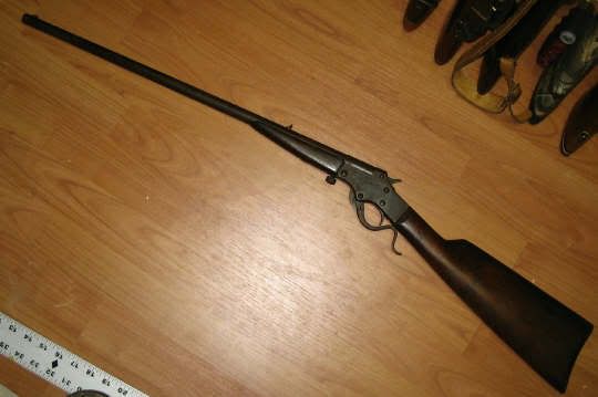

I've got an oldie in .32 thats going to be hitting the EE soon:
Yup, that's a tiip down m12 marksman, I have one that has been rebarreld.
The Favorite ( of which I also have one that we shoot regularly) is not actually a true falling block....

Wrong Way said:
It is! Question is......is that good or bad?
That it is a Marksman and not a favorite?:redface:
Dunno, I think the caliber is more of an issue than anything, because unless one has a bunch of .32RF around, the rifle is a collector only.
Tha, and I am not too sure you would want to shoot original .32RF , because of its collector value?:confused:
It is a perplexing dilema, for sure, 'specially if one likes to shoot old guns!
Mine was rebarrled because the barrel was bulged.
I had a few extra Anschutz barrels hanging around, and one wound up on the tip down!
Complete rework of innards was in order, and a friend did a wonderous job on it.
Cat

Wrong Way said:
The "marksman" and the "Favorite"....I'm confused. I've had two people tell me it's a marksman....but it says favorite on the reciever.....?
Is the marksman a model designation of one of the favorites?

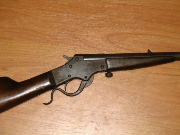

The favorite is a rear swinging block ( a form of falling block)
The Marksmen is a tip down, as pictured.
Yours says "favorite"??!!
Now I'M confused!!
Cat

yah i was about to say its a marksman period:circa 1912-1933...according to the single shot bible as i like to call it by Frank de Haas...originally chambered for .22 .25 .32.....this action to me looks very simillar to say an nef handi rifle.
i think it looks fairly strong as opposed to the falling or say(swinging) block action of the favorite....

Wrong Way said:
Not really the same as the nef, as when you pull down the trigger guard, the action pivots. It doesn't just "release" and fall open, but they are connected. If you swing the guard half way down....the action opens half way. It feels very solid.
And they take down with one screw!
