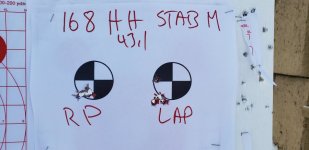

this was back in december. 100 yds at silverdale. 5 rds out of RP brass and 5 of lapua. Yes i pulled a shot with the lapua. Im still a novice.
those are 2 inch circles, for reference.
10tr in mdt lss xl chassis, bipod and rear squeeze bag.
