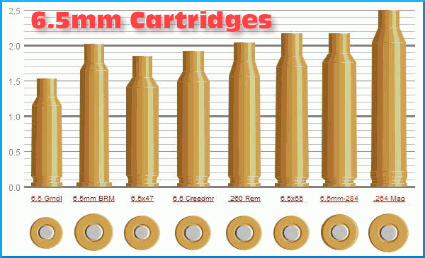

Old school case geometry was long and with soft shoulder angles.
New school prefers shorter cases with sharper shoulder angles and there are subtle advantages to this.
First is throat erosion... A soft shoulder angle is known to generate earlier throat erosion because of the way gas fires out of the case directly onto the rifling. Sharper shoulder angles redirect the flow of hot material onto the inside of the case mouth and this helps protect the barrel.
It also affects back pressure within the case itself and affects how consistently the powder burns. If the powder migrates forward early it does not burn as consistently and velocity with low SDs are harder to maintain.
Next on the roster is case growth after firing. If you are not a hand loader this point is irrelevant, but if you are its important.
Cases with a sharper shoulder angle do not need to be length trimmed as often so it's certainly more convenient and the case weight remains more constant over the life of the case.
This is subtle stuff and the difference between one and the other is not going to make the difference as to whether or not you would win a rifle match because you picked a 260 over the 6.5 Creed.
