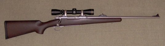

That not completely true either, it came with non-stainless sights as well, as per Winchesters own website -

Only the 375 H&H came with sights
So what, the statement I replied to was refuting the assertion that Winchester stainless steel model 70's were all stainless steel construction right down to the screws and springs with no regular steel or alloy parts unlike the Rossi or Ruger rifles I mentioned.
Besides it is still was a factory option and you could request open sights to be fitted from the factory on many of their stainless rifles, here is one in .308 Win I found with a google search with blued open sights as well -
Also their Alaskan SS model came with Blued steel sights in different calibres as well -
Plus Winchester also fitted different blued steel open sights on another of their Model 70's, the Stainless Laminated model which and also had a alloy trigger guard fitted instead of a stainless steel one, just as quoted in Winchesters own advertising.
Winchester Model 70 1-Piece Aluminum Alloy Trigger Guard, S/A Silver Finish (03). This model 70 factory original part was manufactured by Winchester in New Haven, Ct. Don't miss your chance to get one of these hard to find original Winchester factory parts.
So what is right. 99% of them were all stainless. The Alaskans you mention are newer production with the enclosed trigger (not all stainless)
