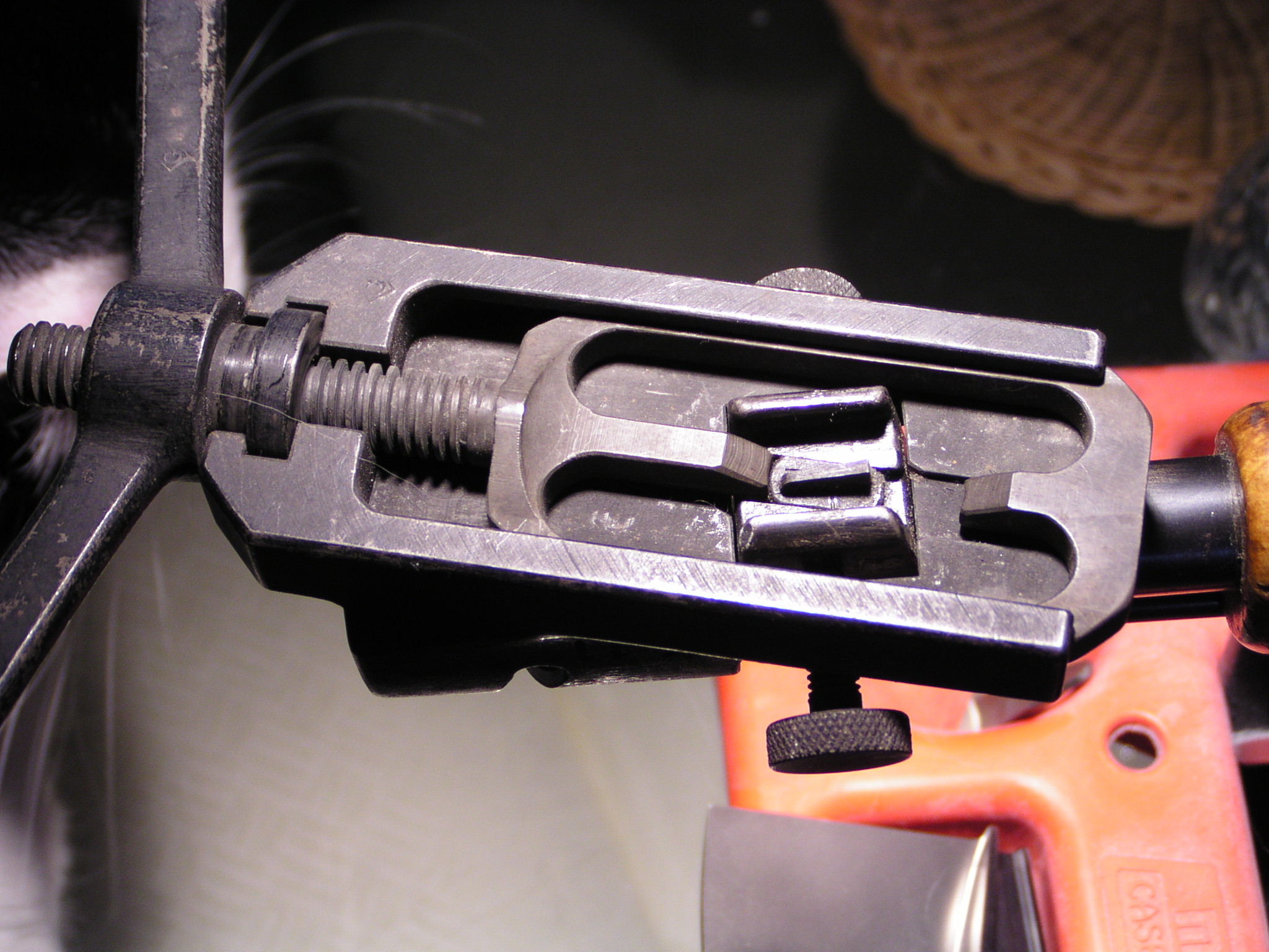

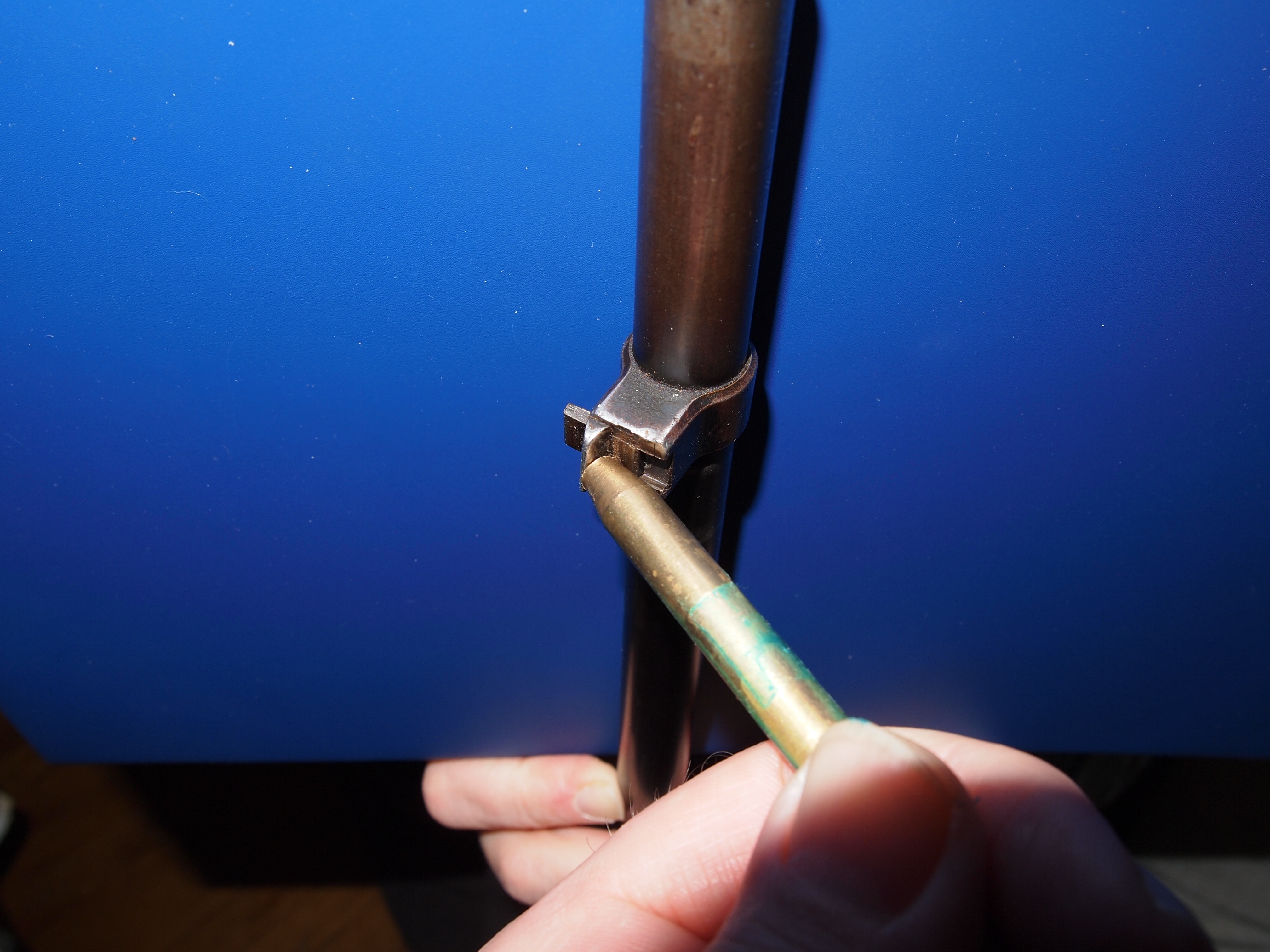

Brass rod and hammer if you don't have a sight puller. like these for the K31.
After oiling: This is a Swiss 1889
Some types were initially zeroed with bayonet mounted which can make a big difference. Some make no sense at all- I had one SVT fresh from the crate (ie post refurb) that shot 2 feet low and 2 feet to the left at 100 yds. It also had scribe marks on the front sight but you have to wonder if they were for the previous rifle that that muzzle-brake assembly was mounted on. For drifting the front sight I like to clamp the sight base in the jaws of a vice using brass pieces as spacers. When that is done the drifting is usually pretty easy and you can measure the distance (in thousandth's of an inch) that you're tapping the blade/ post over.
