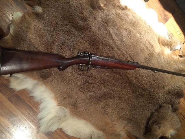

I lucked into a very early and well-worn Rigby mauser that was rechambered from its original .275, still with the original cocking-piece mounted peep sight. It's the finest rifle I own and is what every bolt-action should aspire to. The biggest thing in a stalking rifle is a trim, well-balanced arm that points well and is light enough to carry extensively. Most of the English examples are under 7.5 pounds. An intermediate-length, small ring 98 action like the Mexican mausers would be just the ticket for a stalking build in 7x57 or .250-3000. For extra class, you could go the W.D.M. Bell route and build a .220 Swift companion piece, though you might not want to try his trick of shooting red deer with it with today's game laws.
That's basically exactly what I'm looking for. Add a flip up hood or night sight bead and and maybe some case coloring. Definitely in 250 savage and possibly a larger caliber as a pair. A 275 Rigby stamped barrel seems traditionally fitting though I'd be open to other calibers suitable for such a slim light rifle

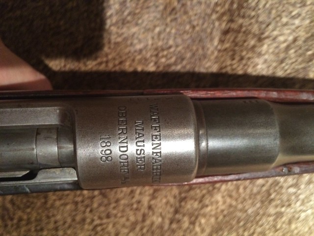

I'm re-working a zastava to try and emulate some of these principles, except with peep sights. But not as nice as this stuff.

M98 parts are perhaps the most common parts out there. Without being sure whether the earlier pictured rifle was a 98 or 96 there are a lot of those as well. One of the nicest stalkers I ever handled was a Charles Lancaster .280 Ross on a Ludwig Loewe M95 -- just awesome.

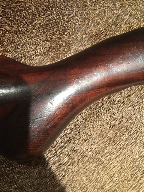

The heart of a stalking rifle is the stock design, designed for the individual. As such they can't really be made on a duplicator, at least not entirely.
