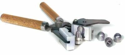

I am currently casting these;
ht tps://slugsrus.com/hammerhead-slug-mold-details.html
They’re accurate in a full rifled barrel to 100yds.

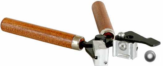

- For what it's worth, I've had good luck with with the Lee slug and/or their 0.690 round ball
Mind you, I just shoot them for fun, under 50y most of the time... just blasting "stuff"
I used both WW and pure lead for both LEE 1oz and Slugs R Us casts. I found the lead to group better.
