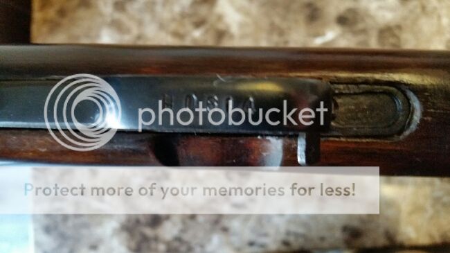

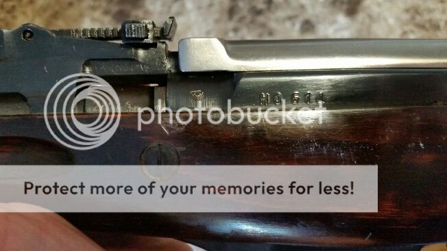

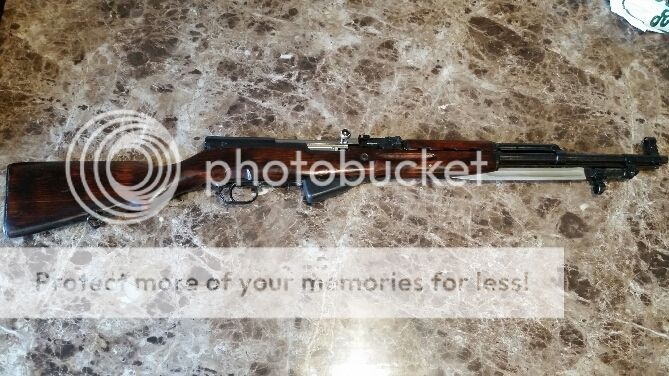

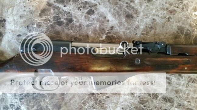

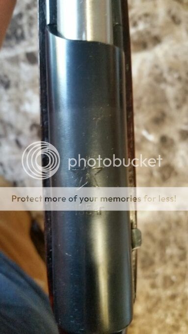

Hey guys, I finally popped my cherry and started my collection of surplus rifles. As with many people, I started with an SKS. Bought this one last night. It seems to be in very good condition, although it's absolutely filthy and I haven't gotten round to cleaning it yet.
It seems to be a Tula 1954, with all matching serial numbers (externally anyways), like I said, I haven't gotten around to stripping it down yet. I cannot find a refurbishment marker on it, and the stock seems to be original. Feel free to correct me if I'm wrong.
If anyone could enlighten me further it would be appreciated!

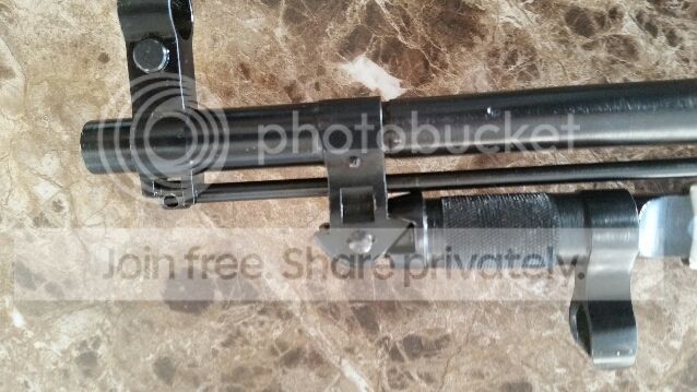

As you said, no apparent refurb marks. Are the peens on the bayonet pivot screw intact? If so, you have a possible unrefurbished, as issued rifle. When you take it apart, check for wear on the contact points, the bolt, hammer face, guide rails, etc. If no wear, that may lend more credence to an unissued rifle. Is the muzzle in the white and unfinished?

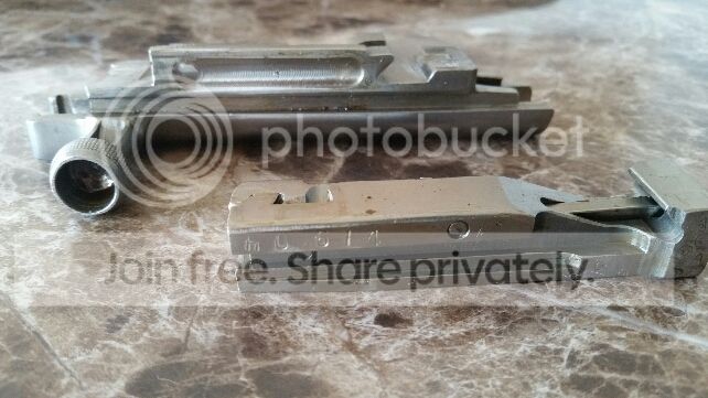

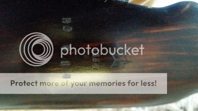

Thresher, here are some pictures whilst I was disassembling. It seems to not have very much wear, and all the electro pen numbers are where they should be. The only one I couldn't find is on the bayonet. It does however have inspection markings on the stock.
It's been shot, not that much by the looks of it though. I have three letter series, with no wear internally or externally, and no refurb marks. Can't bring myself to shoot them when I have a few shooters already. Your rifle is broke in, but almost pristine, it'd make a good shooter without guilt afterwards. Your peening on the screw is intact and original, and no peening from impact on the rear receiver. Hammer face finish is worn as well as contact points for the bolt carrier, locking lug is starting to wear on finish and could be the flash but the front of your follower seems to have wear. Most of the wear on yours could also be duplicated by manually cycling but it was probably shot as well. Enjoy her, you got a better one than the recent imports! Let me guess, got her from Westrifle?

NOt sure what you mean by almost all original. That rifle is on all numbered parts.
The original serial numbers were all stamped. Refurbs had forced matched serial numbers electro penciled onto the parts to make them match.

Your interpretation is correct. The other gentleman is sadly mistaken. Its easier to electro pencil on small parts such as the gas tube, or the piston shank. Stamping would possibly damage the tube as well, changing the internal dimensions. Also, re-numbered trigger groups had the old numbers ground off, leaving a flat spot, and then re-stamped.
