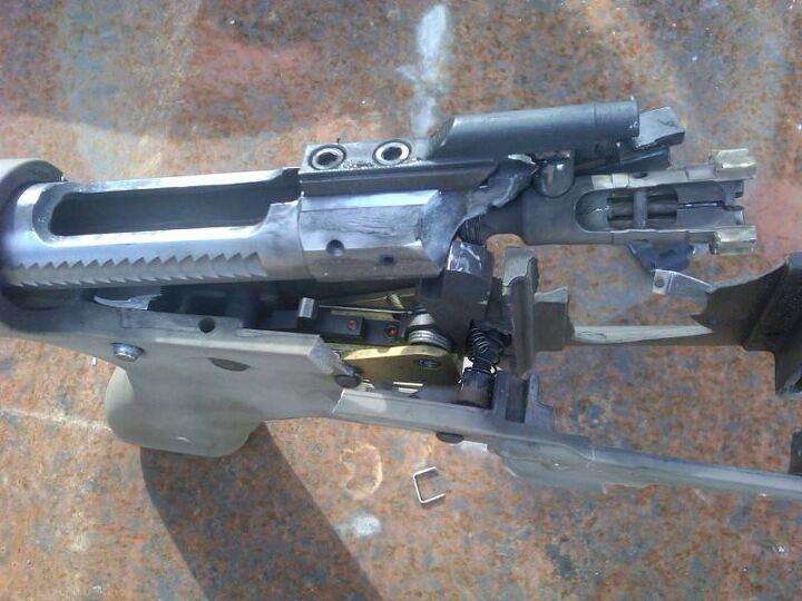

When I was having sights installed on my G17, a Glock armorer that works for a Canadian distributor that procures Glocks for many LEO departments showed me a Glock that was cracked in half after the shooter put a bad reloads through it. It was pretty scary to see. I feel like if it was an all steel gun that might not have happened.

Last IDPA match, this old guy was bragging all morning how he had loaded 45 with rifle primers, because the 1911 is SO STRONG that the firing pin can hit anything and this and that. 1 hour later he was on his way home with a bleeding hand and a destroyed gun...
