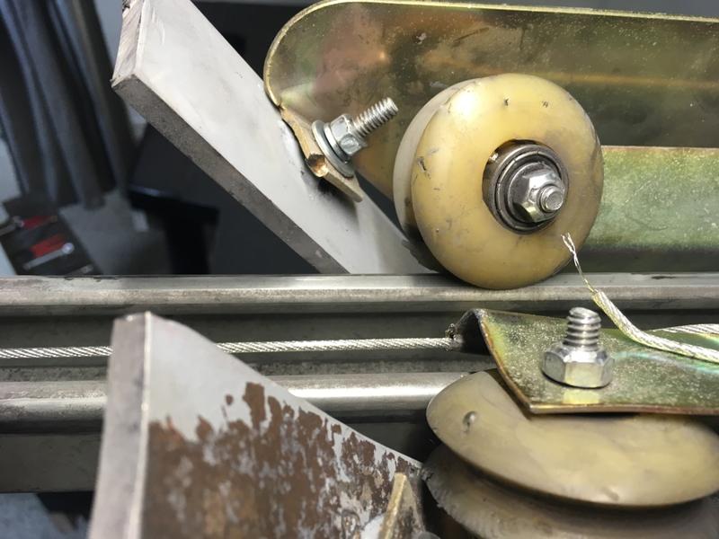

This is the target carrier dolly from one of the lanes in our rifle bay. It is faced with a 1/4" plate of AR500 steel (if not AR550 which is harder), which is really tough stuff.

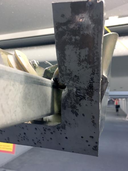

The impact point near the inner edge, the lowest of three impacts with steel cored ammunition (one is right at the top of the carrier plate, and the other is more centrally located in the upper half and shiny) has bent the plate back so far that it is touching the wheel that is behind it and buckled the side of the dolly.

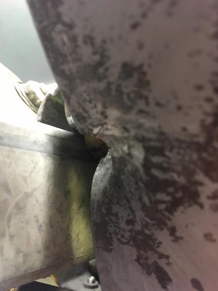

The bullet then ricocheted into the cable stay, the brass coloured plate attached above the near wheel, bending it up into the position shown before at least parts of it came to a stop in the far wheel.
This dolly needed to have the exterior carrier replaced, both of the front wheels from the internal carrier, the cable stay, and the front plate.
