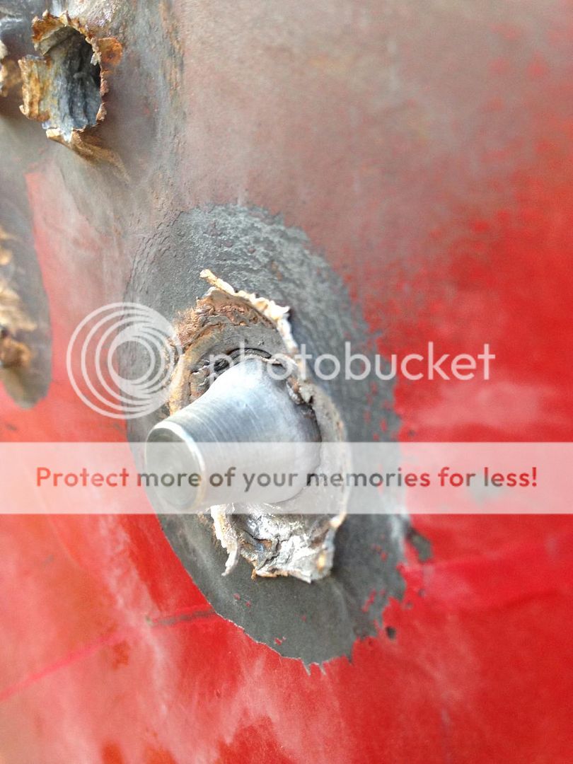

This Picture is from 1"mild steel at 200 yards. The craters are from 7mm Rem Mag with 154 SST, the projectile sticking out was a 50bmg- XM-33 ball. We just wanted to see what would happen.
