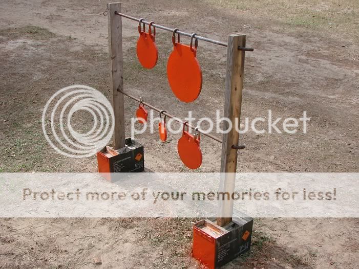

I made this at work and shoot at it anywhere from 50-125 yrds, just make sure your kids wear eye protection, good habit to teach them. And don't use a fixed target, i.e. make sure it can swing to absorb some of the impact.:cool:

I used cement and wood to make a form in the ammo can to accept a removeable 2x4 for the supports.

Ive made several steel targets.Dueling trees ,poppers and swingers.I always angle plates 20 degrees towards the ground.Pocked steel is the wrost thing to shoot at.You can get away with 3/8 or 1/2 mild steel for light load pistol caliber rounds but for .223 and larger Ar 500 is the way to go but its not cheap stuff
