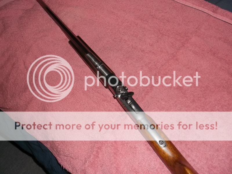

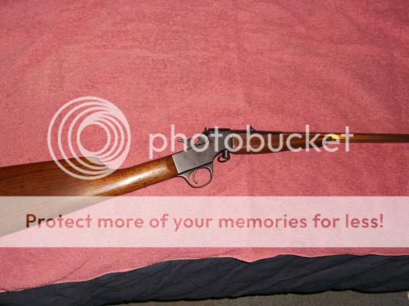

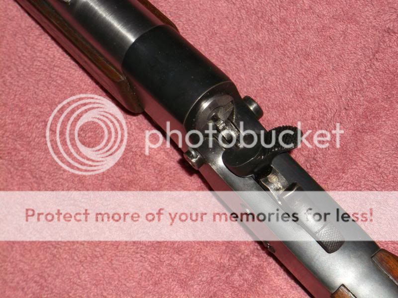

I picked up this project here on CGN. it was a32 rimfire with a sewer pipe buldged barrel, broken top buttstock tang, breach block had the fireing pin welded
and the handle for opening the breach was missing. I made a cro-mo breach block and a hilti nail for the fireing pin. I milled a ruger 10-22 octagon, made a
extractor and a new forarm wood. it weighs 3 1/2 lbs. it has only been test fired so far. oh , I did away with the handle to open the breach and made
a mule ear like the remmy rolling block, that was much easier.
