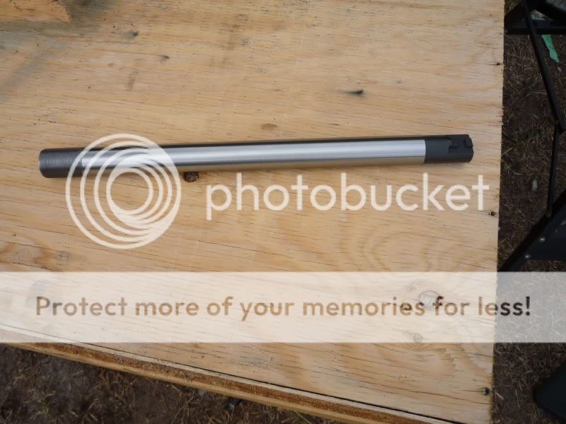

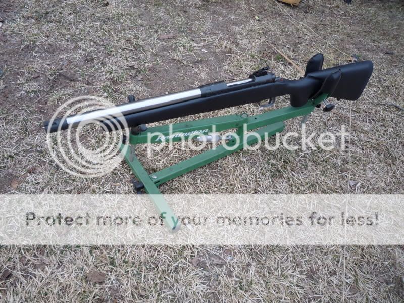

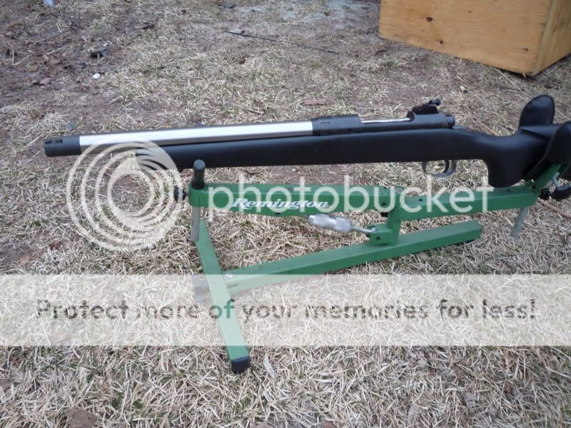

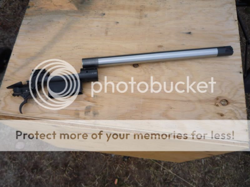

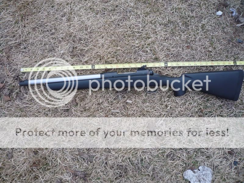

Just made this today. Stevens 200 action, shilen SS bbl 14", single shot adapter
