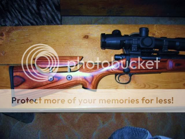

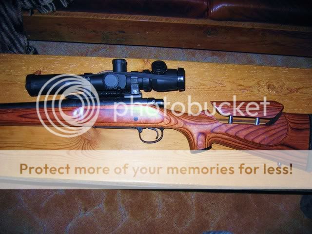

so i've been procrastinating a bit. trying to decide what the heck to do. so i just started sanding and carving and sanding and carving until it felt good. but i'm still not sure on color or color design but i'll probably use auto paint with a hard clear coat.
[/IMG]
[/IMG]
[/IMG]
i would have made the bottom of the butt flat (no notch) so it would sit better in sand bags...looks like a fun project. I always get the urge to make a mess of my Stevens stock when I see these posts :D
