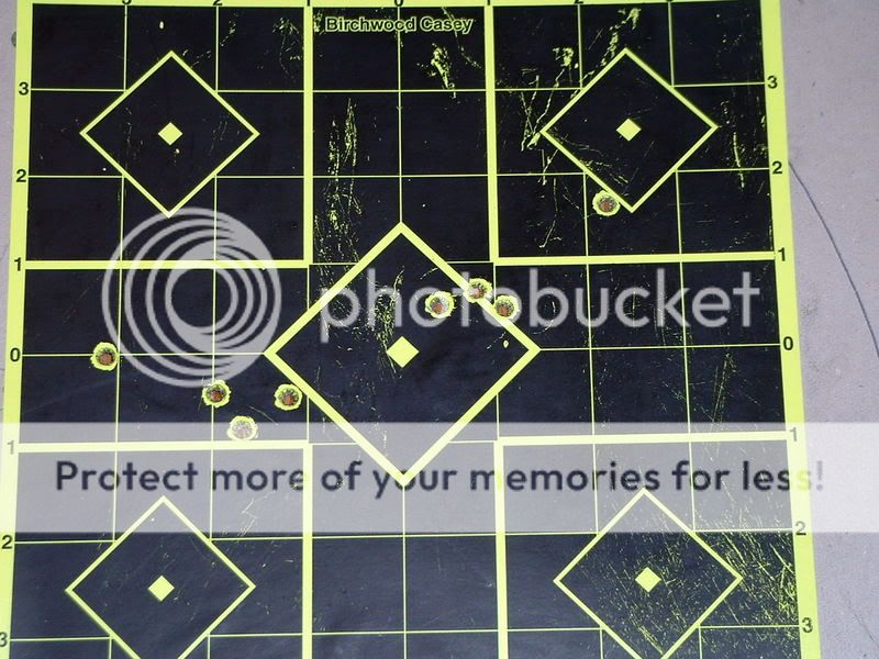

Do any of you stevens 200 owners get nice groups but one always seems to be a flyer? For me, its always the first shot that flies off a little and the rest group nice and tight. (Cold Barrel??)
Heres a pic of my stevens 200 in .22-250 with 55grain Vmax's cruising at 3600FPS. This was shot at 200 yards.
The following are my stevens 200 in 7mm08 shot at 100 yards. It doesnt seem to matter what loads I use, I always get the same type of grouping. Not a really big deal (these are hunting rifles not benchrest rifles)
Does the same thing happen to you guys? How are your stevens groups?
Are those shots (flyers) right after you cleaned the barrel? Most of my guns will have the first shot slightly away from the rest of the group (not a Stevens) until the barrel is fouled slightly.
I have not cleaned them in awhile, but these groupings have happened from day one in both rifles. (clean or after some use)
Once again Im not too concerned about it because both rifles have taken critters, therefore they can put meat on the table. (not so much the .22-250,as I dont like eating coyote or gophers:puke: lol )
I just want to know if others have experienced this with their steven's
Those are significant flyers!
What kind of time between shots?
I would look seriously at the bag and rifle supports to ensure your supports are consistently the same. I.E. forend stud position relative the front bag as well as the rear stud relative the rear bag... etc...
If bedding is good (screws snug tight) and mounts are tight, I'd look long and hard at technique....
Joe
What you are seeing is the result of the rifle being pillar bedded, but not glass bedded. The action sits on the pillars, but can still move slightly from side to side. It doesn't take much, just a few thousandths of an inch to produce what you are experiencing.
After the first shot, the recoil sort of settles the barrelled action in the stock. The next two or three shots do the same, so you get the first shot out of the group.
Just bed the receiver ring and recoil lug area, and a small pad under the rear tang, and watch this problem go away. :)
Ted

I agree with Why Not's diagnosis. In addition, if you look at the pillars, they are flat at the top where the "round" bottom of the receiver comes into contact. You'll probably see a shiny spot on top of the pillars which is evidence of this shifting. Bedding will clear up this problem. Are you having this problem with a tupperware stock or that laminates stock on your 7-08?

I have a Stevens in .223 and the first groups I fired had fliers. I bedded the action and now my $350 Stevens shoots almost as good as my $1700 Sako.

So which of these are pillar bedded? I have yet to see this kind of problem on a pillar bedded rifle....but then maybe I should be saying properly bedded in a proper stock...:D
BTW what happens when you shot 5 or 6 shot groups?
Bedding is your number one problem. Both stocks come with very generous inletting - catch phrase is drop in inletting = not so good inletting..
Pay attention to the recoil lug and ensure that it is bedded on the sides and as much of the front as possible.
Try and keep that action as level/stress free as possible when bedding. You do not want to bend the action. In many cases, the rear pillar is a bit too low.
I focus on having the action down so that it touches the front pillar and level between the rear and tang. One of the other will touch for your two point contact. The bedding will fill in the gaps and you will have a stable level base.
You have done the bedding right when the action, just put into the stock, cannot move in the stock in any direction even with some pretty vigorous tugging. It should feel like it is bolted together.
Action screws only need to be hand tight and will go from loose to full tight in 1/2 turn. Anytime you feel the screw get tighter and tighter over 1 to 2 turns, you are crushing the stock and/or bending the action.
Any action properly bedded w/pillars never needs to be 'torqued' down.
The fliers will dissappear and groups will shrink.
If shooting in very cold weather, that barrel may change harmonics as it rapidly heats up. so if the fliers go away but you intend on hunting in -5C or colder weather, test your cold barrel shot in these temps and see if it is off.
Some barrels change POI in the cold, others don't.
Jerry

this is my LTR before it was bedded at 100meters
I was happy...but it was time to get the trigger down to 1.75lbs;) and bed it so after a long time working on it I put her all back together,tightened the action down to 65"lbs I loaded up some more ammo and off I went again this time I fired three shots to confirm zero then I shot a 4 shot group...(I know I only had four rds left,I am still trying to find it magic load:D ) here is the pick of that group
