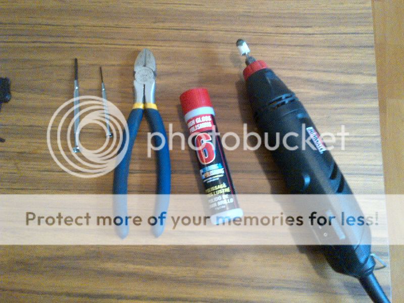

Alright so what do you need to work on this trigger? Not alot.
The small screwdrivers are just used as punches, and to pry. The cutters are for taking out the slide release spring, and the dremel is to polish using the compound, as well as chop a coil or two off of the mainspring.

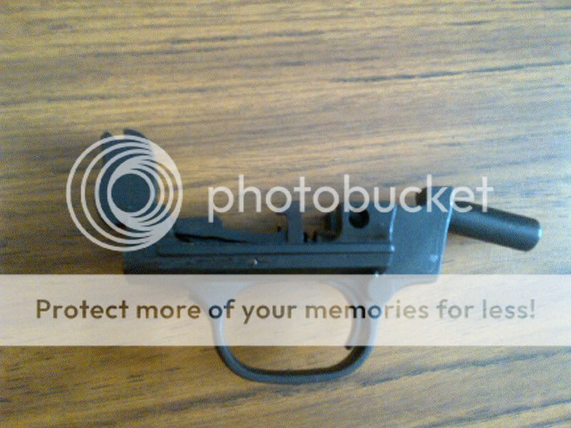

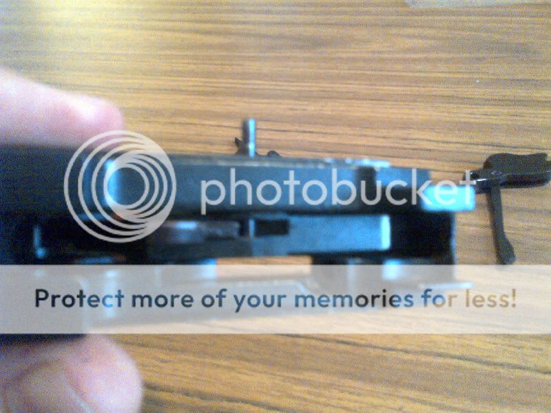

So first step is to take a good look at everything and figure out how everything works. It is really a quite simple trigger group, and nothing to really be scared about. Everything is held together with 3 pins, and a couple springs so remember what it all looks like, as it makes it easier to put back together.
Just a note. Start with it like it is above, with the hammer released. It makes it alot easier with no spring pressure to fight.

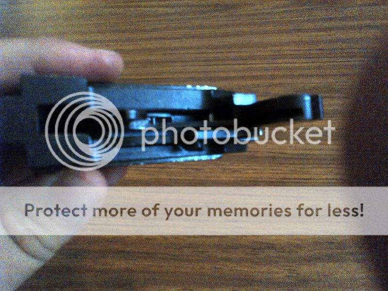

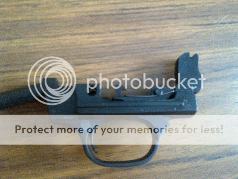

Alright first step is to remove the little wire spring that holds the slide release forward when the hammer is cocked. Again with the hammer uncocked there is no pressure on this spring. Cocking the hammer and releasing it will show how this spring works.
Anyways hammer uncocked, and I simply use a small screwdriver to pry the spring out of the hole which will allow it to drop free.
After the spring is gone, you can see a pin holds the whole slide release assembly into place, and that there is another spring underneath it. Keep in mind this same pin holds the trigger in place as well, but at this point you should be able to remove the pin entirely, just don't lose that little spring when the slide release comes out.

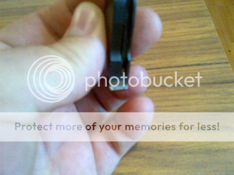

Next step is going to be to remove the hammer which again is just held in place by the larger hammer pin in the front of the trigger housing. Just knock out that pin and it will fall out no problem.

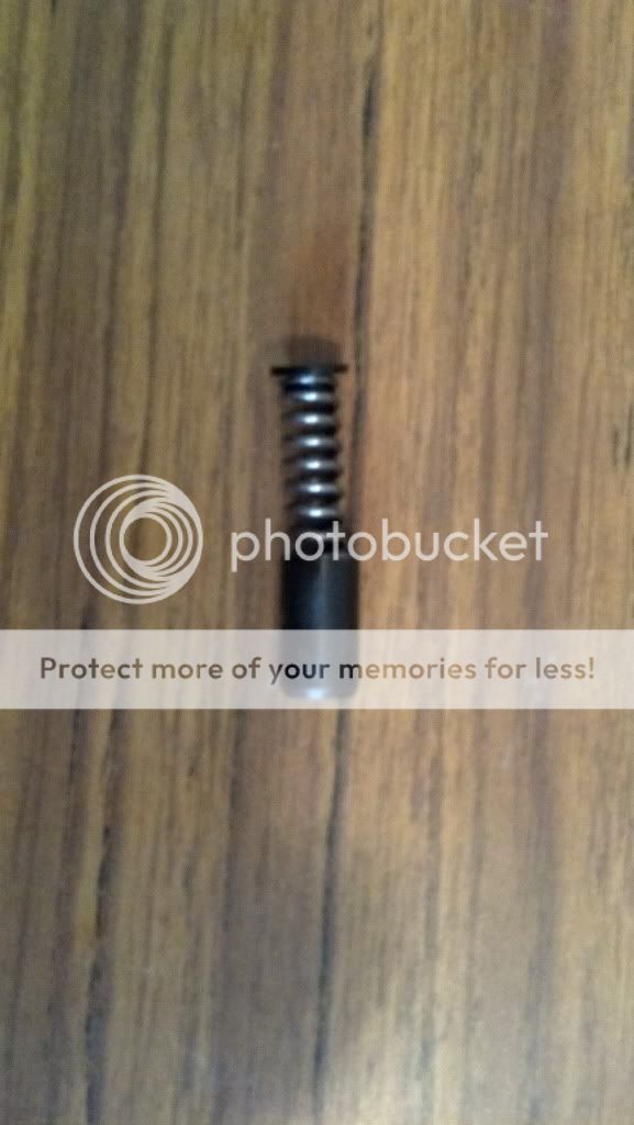

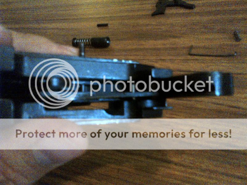

Now you can see the mainspring, which is the next thing to come out. I tried getting the trigger out first but it seems the mainspring kinda gets in the way so first lets remove the mainspring. Again the only thing holding this all together is the little pin at the back of the trigger housing. It is just holding the spring from shooting out the back, but now that the hammer is gone it has no real pressure on it. Just knock out the little pin and the 3 piece mainspring assembly will come out the whole in the back of the trigger housing.

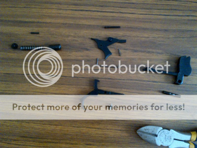

After that is out the hammer should just lift out easily. Again be careful here as their is a tiny return spring under the hammer, with a little detent in the trigger housing that it sits in. Make sure you don't lose that spring.
http://i801.photobucket.com/albums/yy291/mlehtovaara/guns/triggerou####chthespring.jpg

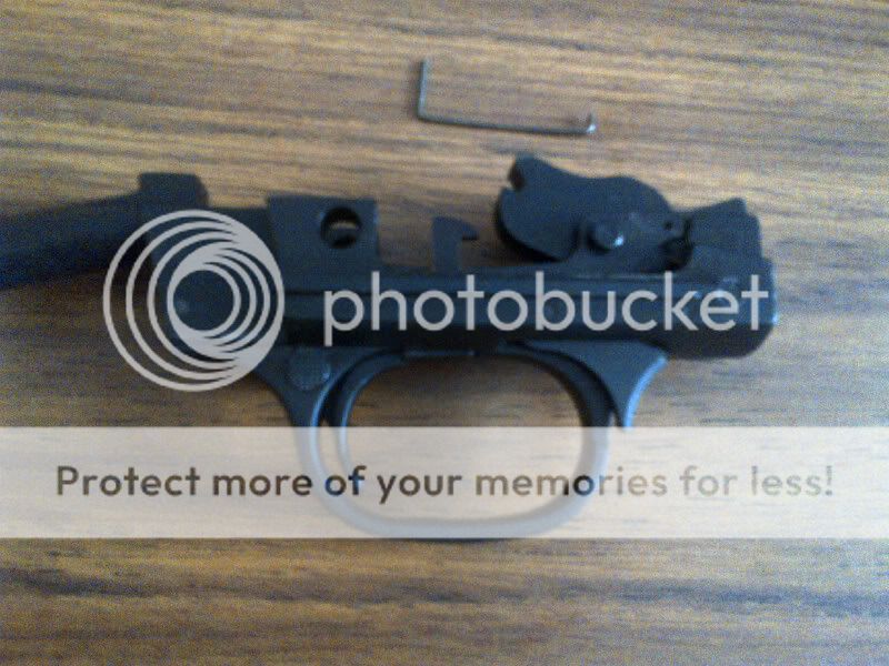

So here is what you should have in front of you.
The pieces that you need to do some work to are the hammer itself, the trigger, and the mainspring.

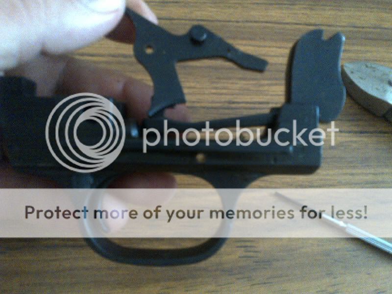

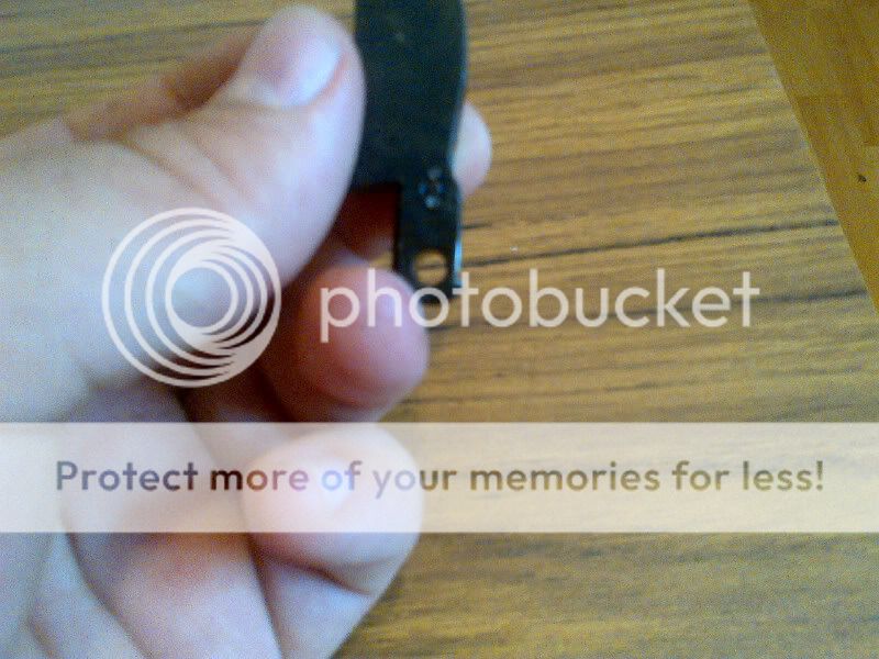

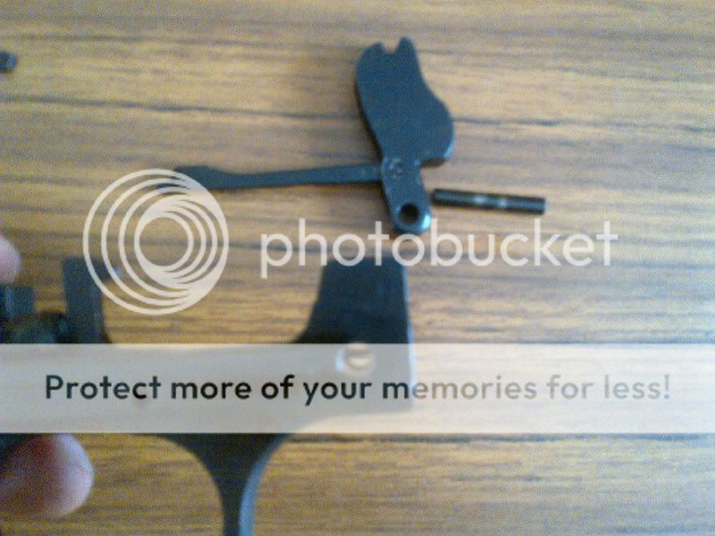

Hammer hook here. You can see where I have polished.

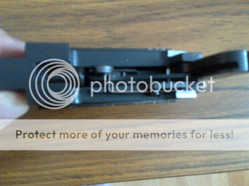

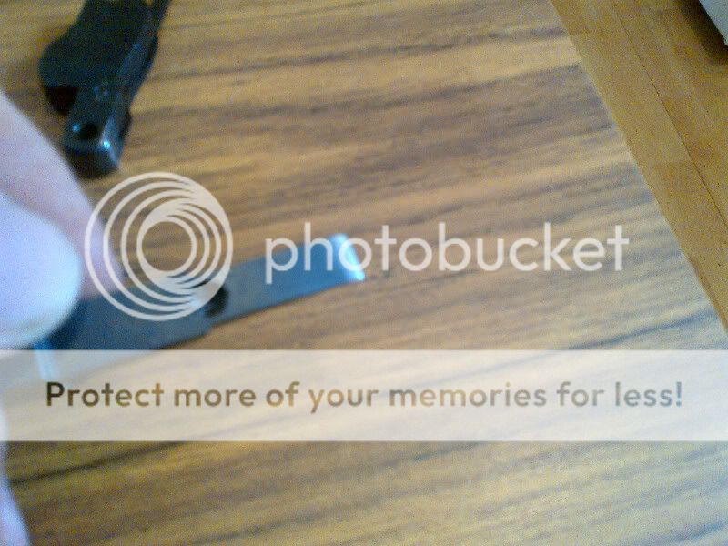

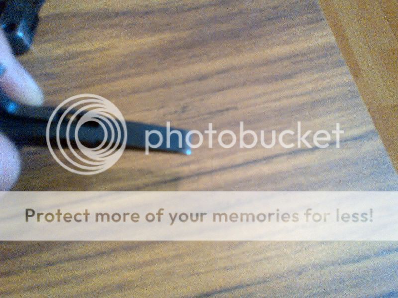

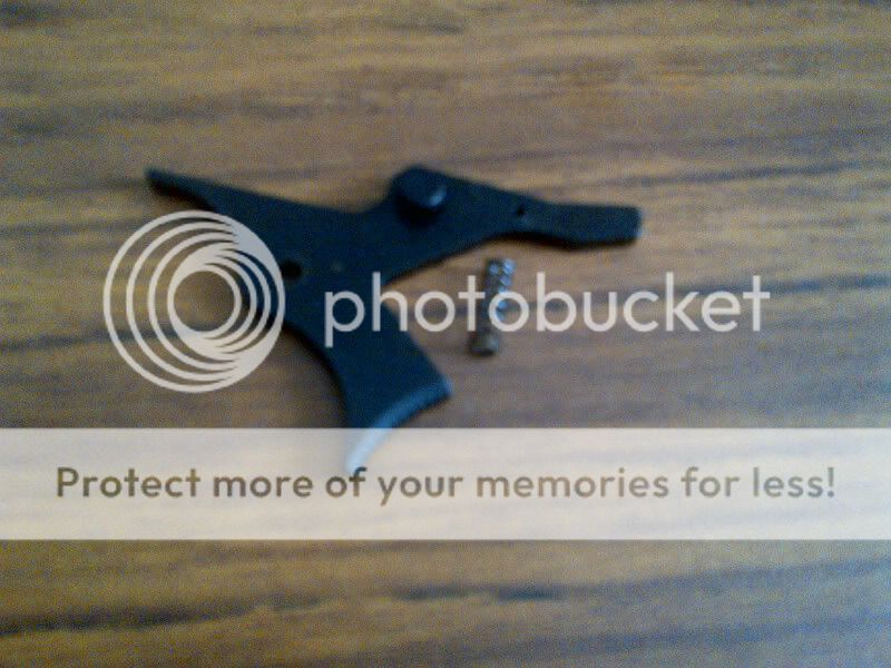

Trigger, again you can see where I have polished. Be sure to get the underside as that is where the hammer hook catches.

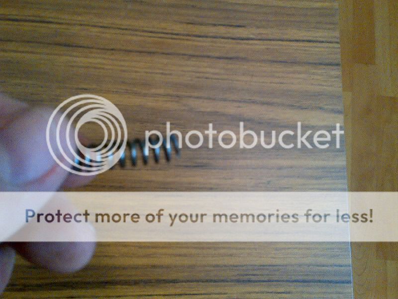

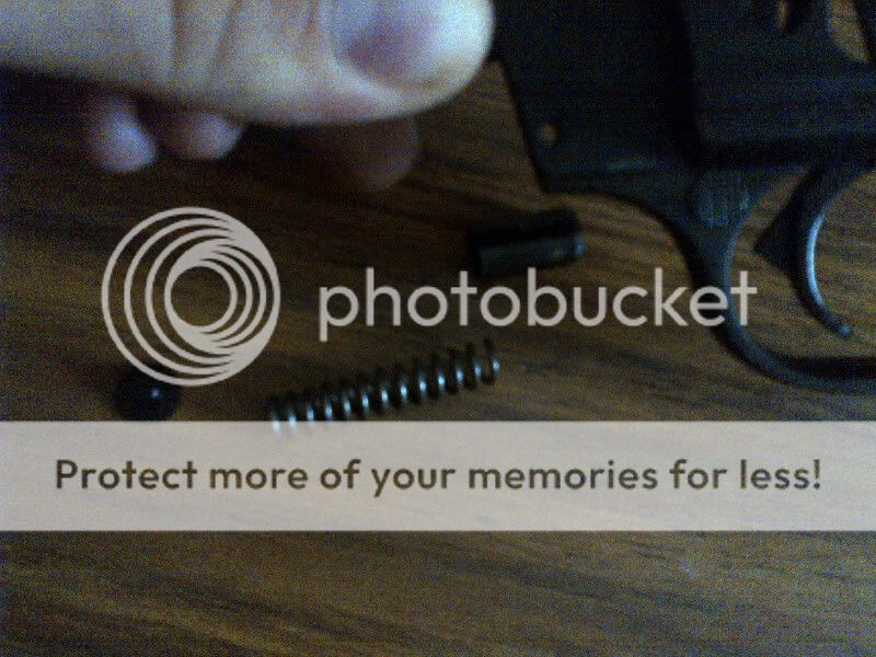

Lastly the mainspring needs to be cut. I would be careful here as reliability may suffer if you cut too short. So far I have cut 1.5 coils off of it, and have had no issues. I would recommend cutting then testing then cutting again till you get the desired results. There also has to be enough tension here to keep the gun from going off if dropped or knocked so tread lightly.

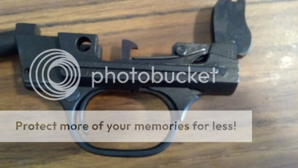

Last but not least the mainspring goes in the back end. Make sure the hammer bar seats right into the cup, and that the spring is all put together properly. I put the cut end in the cup, and the little cap on the flat end of the spring. This stops it from seating crooked when trying to push the spring in and seat that final pin. Basically here I put the pin in slightly just so it is ready, and then use a screwdriver the push the spring in, so the pin will clear. Again just takes some patience but nothing special.
And it should all look just like when we started.
