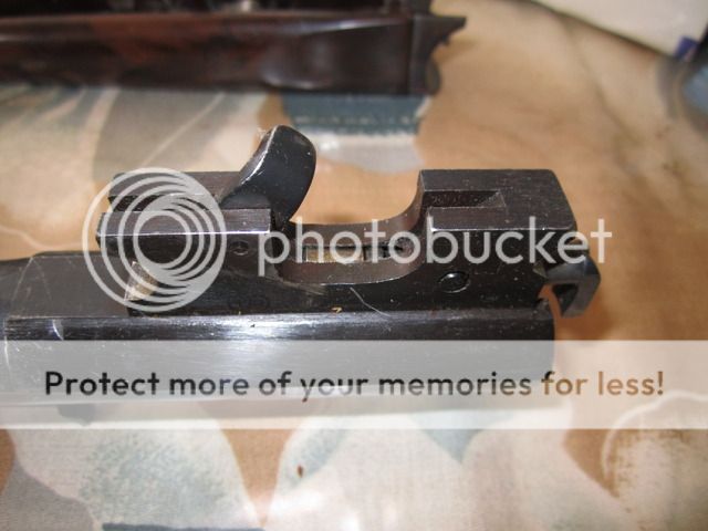

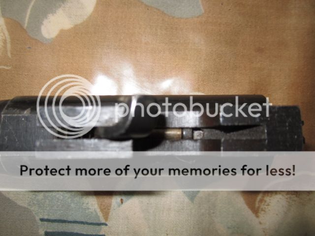

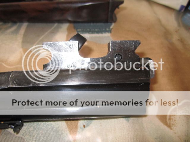

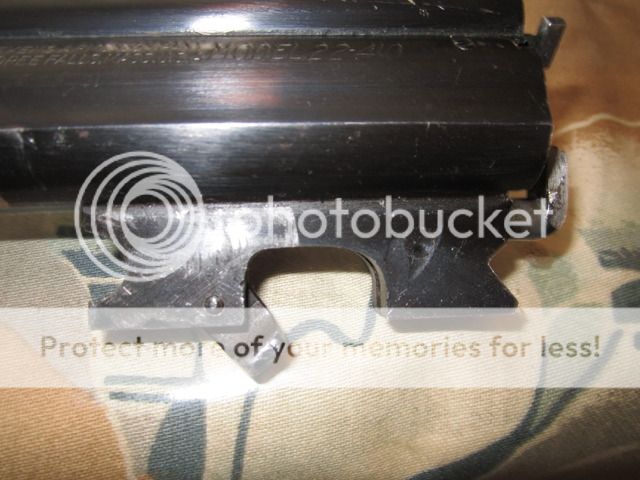

Hi all,
Wondering if anybody has any pictures of how the shotgun barrel extractor and extractor lever goes together in a stevens early model 410/22. I'm putting together a gun from pieces for a friend and want to make sure it's got the right parts. I looked at the diagram from numrich, but it's not detailed enough. The extractor lever may also be damaged and need re manufacturing.
Thanks for the photos! That confirms that my lever is damaged. It flips all the way around with spring pressure. I will build a new one out of stainless and fit it.
