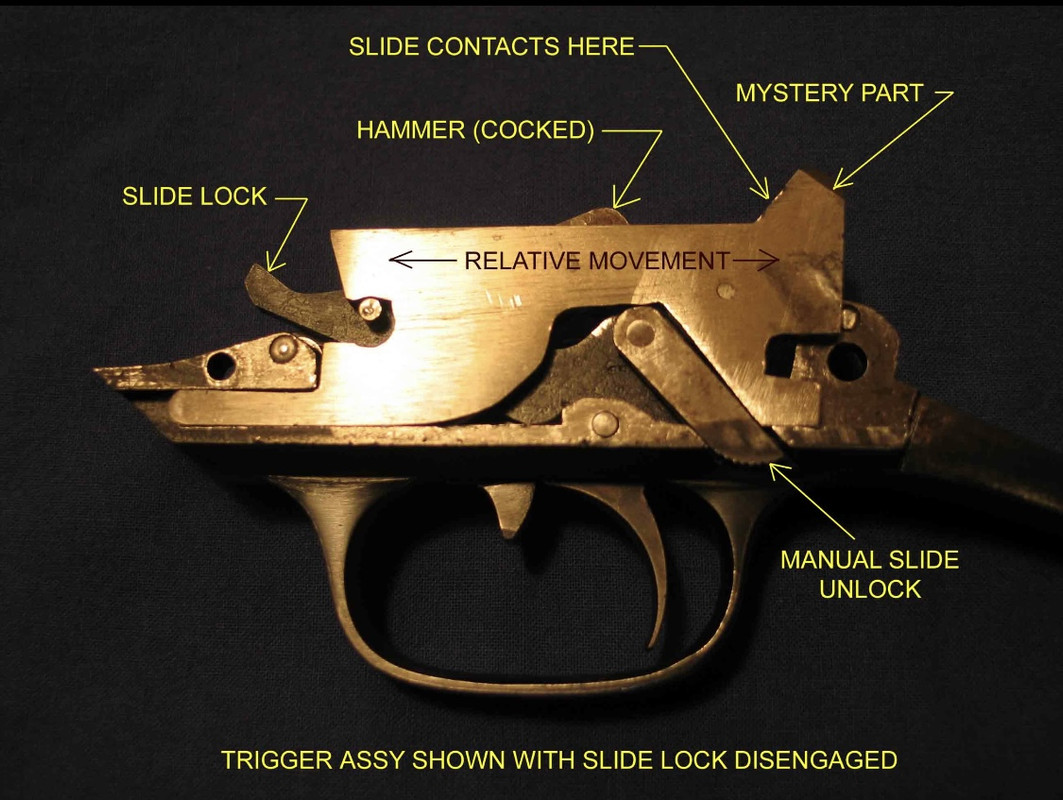

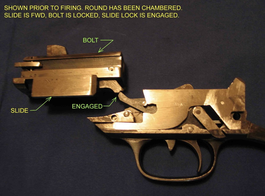

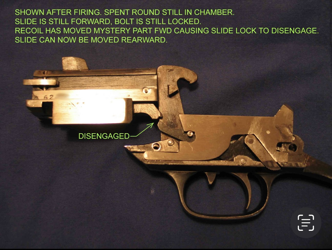

I have a 522 trapshooter which is a bit different where inertia comes into play to release the slide lock. Or if just cycling the action, the only other option is to depress the manual slide lock.
Some of the 500 series also need to have the forend slammed forward assertively for it to release. Not sure, or familiar with your 77 if it’s something similar.
Here are some images of my 522 internal workings if it’ll help.
If anything, it’s an interesting system to see.
Interesting series of photo descriptions. Maybe on a quiet winter's eve I will take the components out and line them up similarly to see exactly how it functions, and why it is malfunctioning.
