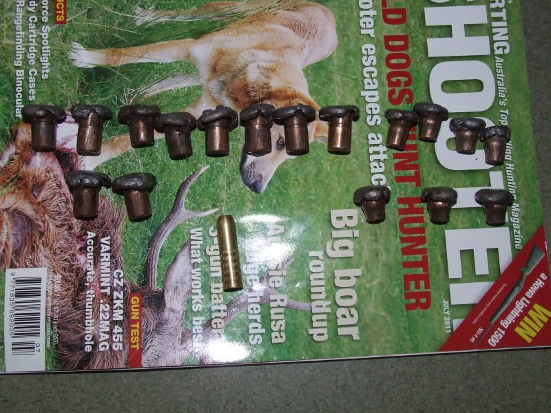

I'll save you the time, they will all look like this when you're done, assumeing you find some critter big enough to stop them. The .375s on the right do the double upset.
