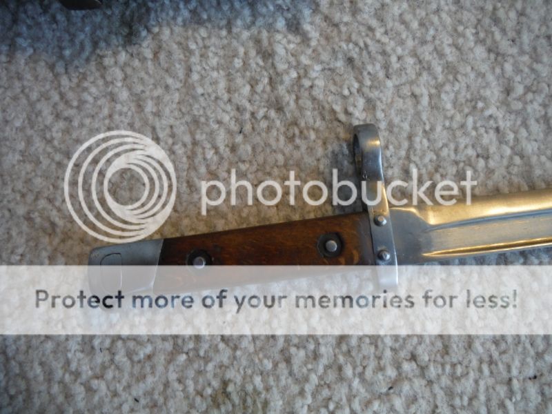

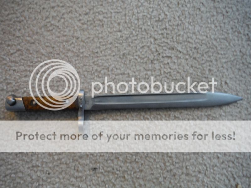

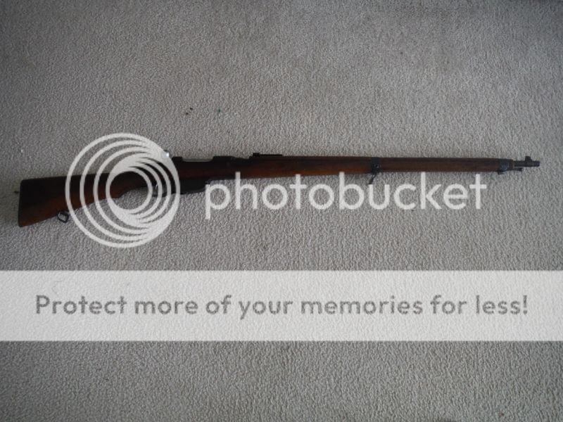

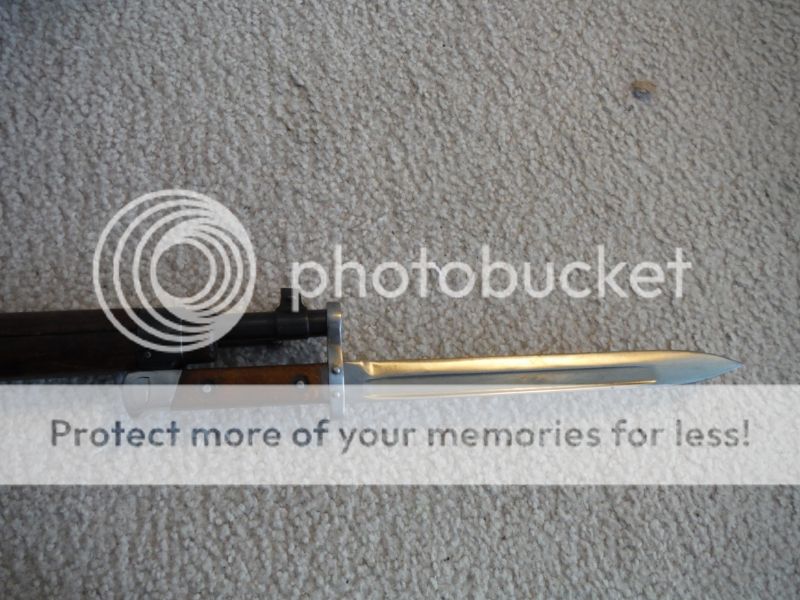

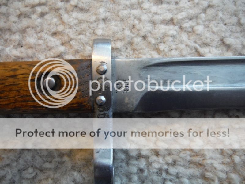

Hey all,
I have some pictures to upload (hope this works). Mine is a M95 Long Rifle manufactured in 1917 (based on the crest). It has been converted to the 'S' standard. The issue is the bayonet lug doesn't fit on the bayonet (I have disassembled it and tried the lug out to be sure, had to use a mallet and punch to get the bayonet and lug apart).
Your bayonet is just like mine except yours is a Budapest made one as you mentioned.
You do have a beauty of a Steyr long rifle, have you shot her yet ? Is the retaining screw for the lower band not present ?
It is missing the lower band screw, it didn't have it when I got it, just another part to source unfortunately. I haven't shot her yet (got her a couple days ago) and unfortunately due to the restrictive rules regarding shooting on crown land in nova scotia I probably won't get to shoot her for a while yet (at least until I get a gun club membership somewhere). If you look at the picture where it is half fitted it shows the bayonet is arching downwards from pressure from the barrel and lug (lug is either too short or bayonet is too long) and the lug doesn't fit the bayonet. Probably a quality control issue with the lug I assume.
The lug may also be damaged as one of my M95s has a lug that has been damaged some time in it's past.
Regardless, you have a nice pair for your collection :).
