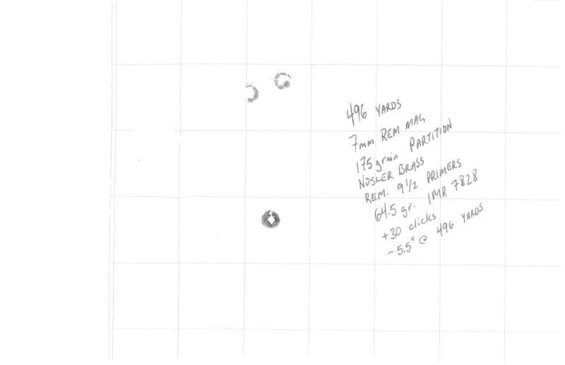

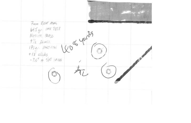

I agree, there is something up with that rifle. My Steyr (Model S Luxus) has incredible accuracy and shoots almost everything very, very well. With that rifle I consider a 1.5" group poor, 1" groups common and the best loads go into well under 1/2". My friend in Alberta used to have a Model S and Model M - .300 WM and .270 Win respectively, and he had similar results. As a side note those Steyr rifles came with a factory test target that included the bullet manufacturer and weight.
Here are two groups....
