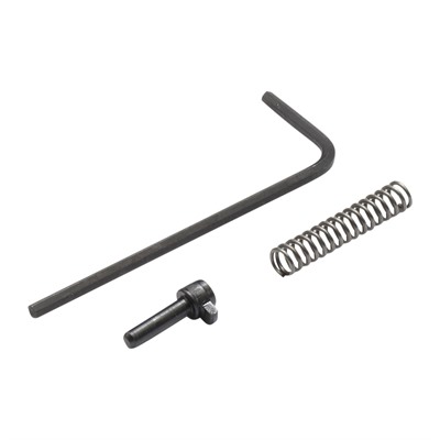

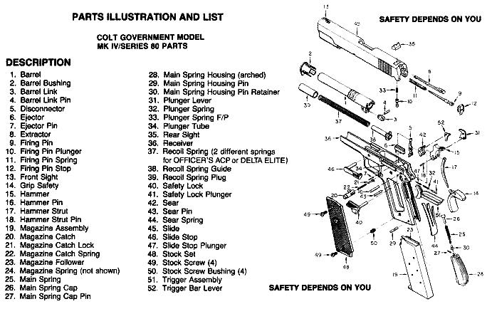

I have an STI Ranger II in 9mm. Functions flawlessly, but I have been noticing an odd issue.
When doing fast mag changes, when I get to about the second or third mag change, the mag release will have worked it's way out and lock itself open therefore dumping any mag inserted onto the ground.
To fix, it requires you to stop (make the gun safe) then take a small blade screw driver and turn the screw (on the ejector port side) of the mag release so it "pops" back into place.
It's as if you're trying to remove the mag release button by pressing it in and turning the screw partway and leaving it there. Locking the mag release open so it does not retain a freshly inserted mag.
Anyone have any suggestions or ideas on how to fix this?.
