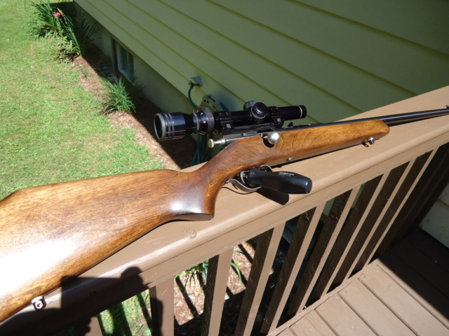

what he said..............just a tip the COOEY 39 will shoot just as well .less weight . and trouble free. yes it is a single shot but i can reload it just as fast ..my mod 39 below ..
