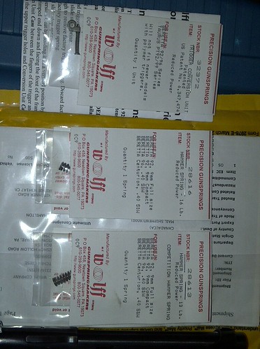

FYI...
For the Beretta the Wolff Competition Triger Conversion dropped 0.5LBS and the Wolff 13 LB Hammer Spring dropped another 0.5LBS. The pull weight is now at 4.5 LBS (it was 5.5 LBS).
Here's a photo of the parts uses (plus one other):
