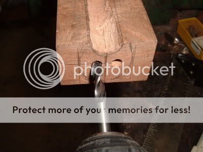

It is common to use two correctly placed wood dowels and clear 24 hour epoxy. It needs to be closely fitted and clamped well.

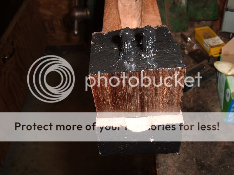

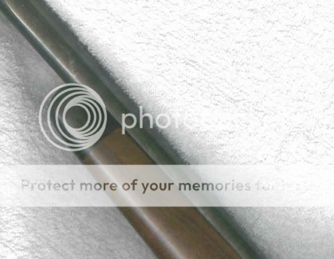

Here's how I do the tips on my stocks. I use Brownells Acraglas Gel with their black dye.

I forgot to mention that it's a good idea to drill the holes about 1/16" bigger than the dowell. It makes fitting the fore-end tip to the stock a lot easier. The difference is filled by the epoxy.

If you can find a set of dowell center markers.They will help to transfer the marks from one piece of wood to the other.
Nice illustrations Mauser98.Good trick with the bike tube.I am lucky enough to have a set of 48" pipe clamps.I turn the rifle stock to the side so I can glue and clamp the grip cap at the same time.
