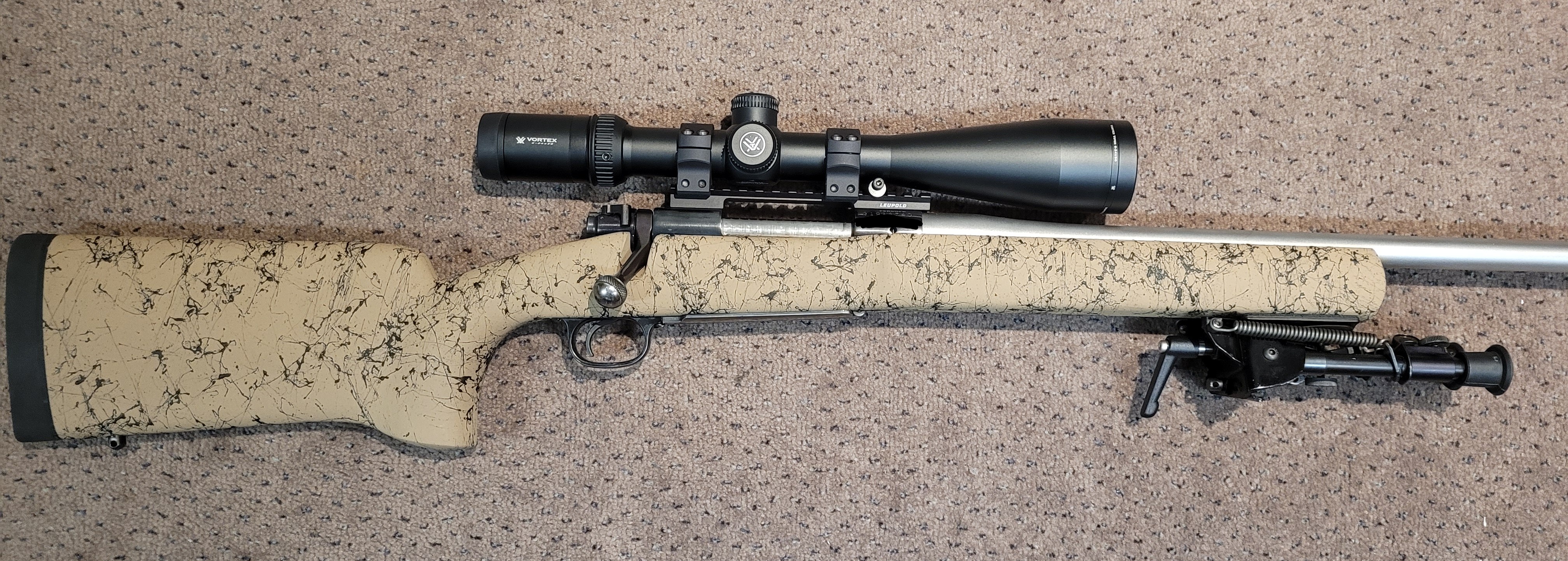

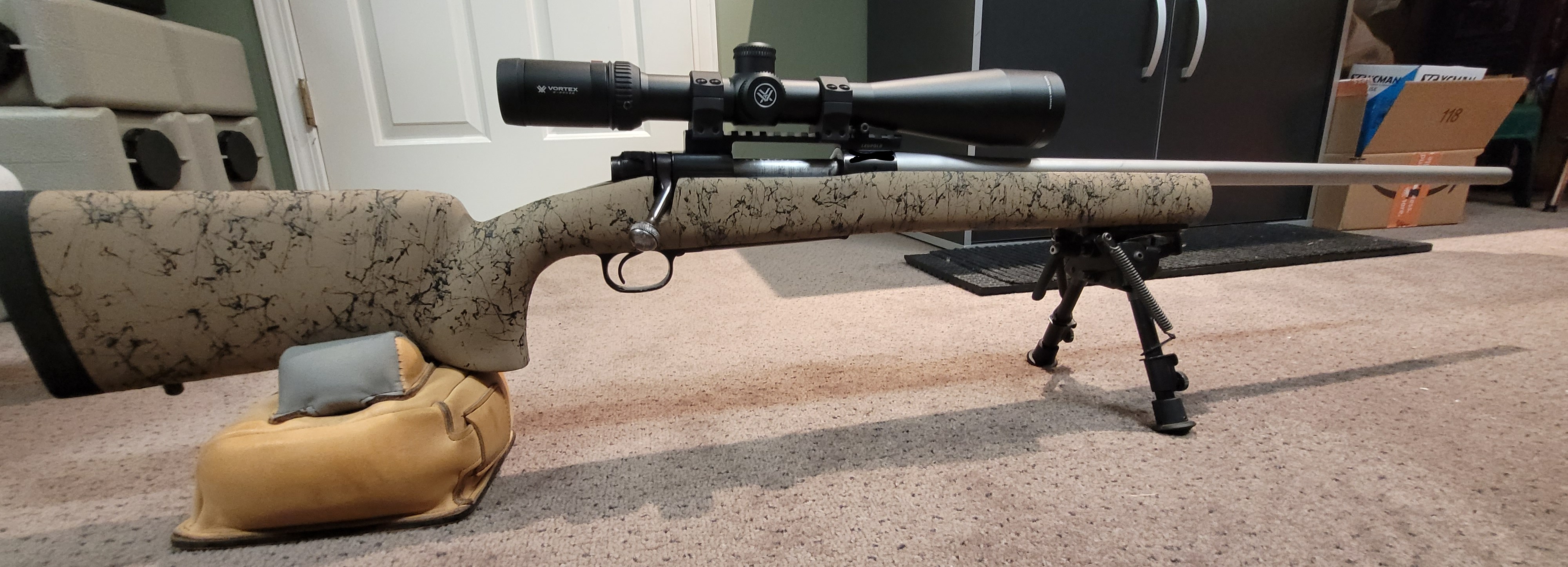

HS Precision M24
I built and bedded M70 in an H-S Precision Pro-Series M24 Vertical Grip stock with a hunting profile barrel. It has an Uncle Mike's Ultra-Mag recoil pad which soaks up recoil a little more than the hard rubber butt pad that the original stock came with. It comes in at under 400USD so it can be imported from the US.
Does the rifle have a one piece or two piece bottom metal? That can add some cost if it needs to be opened up or converted. I have an HS Precision with a sporter barrel channel I pulled off a two piece bottom M70 due to featherweight contour - massive gap around the barrel. They have a two-screw solution for aligning the barrel to the action though which is pretty neat.
