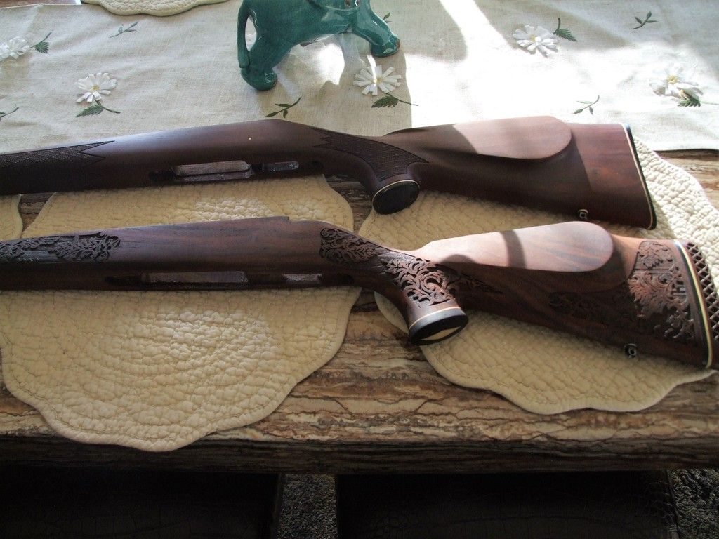

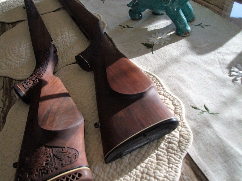

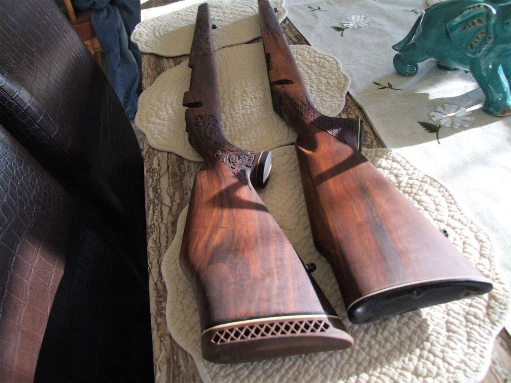

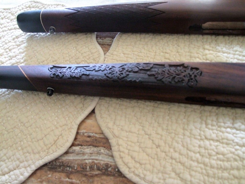

Thought I would post a few pics of 80's vintage stocks I stripped and refinished with Scherells Schaftol.
This is a European oil type finish for that classic look.
Minimum sanding, Protects the wood very well and easy to work with.
#1 stock is an early 80's Weatherby Laser Mark with the shinny factory finish that was in rough shape.
#2 stock is an 80's Remington 700 that was in rough shape.

Yes the light in the picture, It fills the grain quite well you add coats till it wont soak up anymore.
The oil has a silicone mixture that helps fill the grain.

I did a Martini stock in Schaftol dark. It takes a good month for the finish to fully cure, but the end result was quite durable and it really enhanced the grain.
