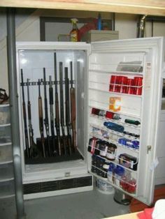

The 8 gun stack-on cabinet at CT goes on sale every now and then, but that may not last long before you're upgrading to a bigger cabinet or safe (They say 8 but they're really small!). It can be expensive starting out in this hobby, and I'd rather spend my money on ammo. Do you have an old fridge lying around? could also check Kijiji or GCsurplus.ca for school lockers / lockable storage cabinets for cheap.
Can honestly say in my many years I have never seen an old fridge used. Looks some cool no pun intended
Cheers
A friend of mine converted an old water heater to a gun safe after they installed a tank-less system in the house. It looked totally legit - along with fake piping, wires, valves, etc - It was very well done.....
Wow! What a great idea! Having your gun collection locked up in a place that thieves would never think of looking at. Much better than a Stack On.:d
