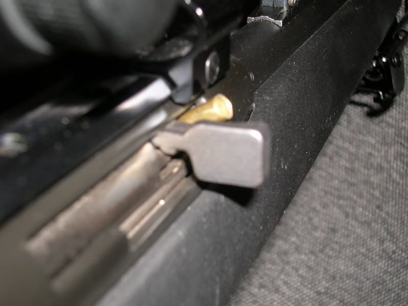

I was out shooting my 597 TVP for the second time and I could not get through a 10 rd. clip without a jam. The gun would fail to eject the spent round and the bolt would jam on the empty shell.

Could someone please define "stovepiping" for a noob? I have heard it mentioned alot. I gather it is "failure to eject" or is it more than that?
Thanks.
A newly fired round would still have smoke coming from the empty casing sticking out of the reciever. Hence the term stove pipe.
