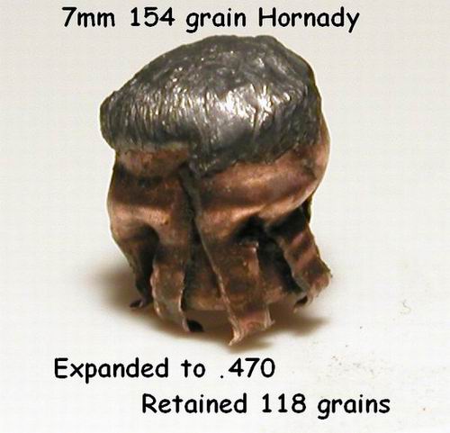

Hornady was my bullet of choice for hunting coyotes, deer, antelope and moose and superb accuracy for 50 years... in 280 Improved and 7mm 08. Typically no exit on larger animals with a quick kill - all the energy in the animal. 139's and 154's were the weights I used. Lots of 1/2 inch groups with both...

That 7mm bullet performed very well. The lead is definitely not attached to the jacket though, like a bonded bullet would be. If that bullet was driven faster, or tumbled inside the animal that core will definitely seperate. Basically perfect performance at the impact velocity you had.
