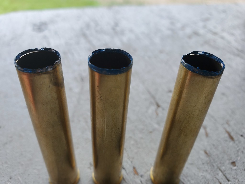

Well I'm back again and still trying to zero in on a good alloy for hunting bullets. I started a thread a couple below this one asking the more knowledgeable folks here what they would recommend and used that info as a starting point.
I went to the range a couple of days ago with my first batch of cast and two rifles borrowed from friends for testing. I had with me a Marlin 1895 in 444 Marlin and a Marlin 336 in 30-30.
The molds used were an NOE copy of the ranch dog 311-165 TL with gas check, and the 444 marlin was cast from an accurate molds 43-300B. Both bullets are tumble lube designs, both powder coated with eastwood tool blue, both gas checked, both cast from 20-1 alloy. They tested about 7.8 BNH with the Lee hardness tester. The 444 bullets were sized to .433 and the 30-30 bullets were sized at .312, as the marlin micro-groove bore slugs at about .3108''. The 444 bullets weigh in at 300 grains, the 30-30 weigh 170 lubed and checked.
I settled on 20-1 for it's expansion properties on game, however I realize it might be way too soft. With the powder coat and gas check I was hoping too expand the useful envelope of these bullets.I had no leading in the barrels of either rifle.
That being said, the 30-30 didn't group particularly well. About 4'' at 50 yards, and since its scoped and I had a good rest, I think the accuracy issue must be with my bullets. It didn't string in any direction, I just got repeatibly bad groups. For a short range hunting rifle, I can live with 3-4'' groups at 100 yards but not 50. The load was 30 grains of H335, case neck flared with a lyman M die and all charges weighed by hand. I fired a couple of other groups with different charges but this one preformed the best.
The 444 grouped amazingly well. It's one of the newer ones with the ballard rifled barrel and seems to take to cast lead very well. However, as you can see from the pictures (or maybe can't, I hope the links work) all the fired cases had a ring of lead and powder coat at the case mouth. This ring is not on the case but just in front of it. I took a chamber cast (picture #2) and I can't figure out why the bullet is being shaved like that. The bore measured close to .432 from the cast, so a .433 bullet should be just what the doctor ordered. It just doesn't explain the shaved lead on the neck. Load was 54 grains of H335.

With the .444, your brass might be too short, causing the bullet to start expanding in the leade area, then being swaged down to the bore, cutting lead rings. These lead rings will eventually enter the bore and cause leading there too.
Somthing weird is going on there anyways. The lead rings are almost exactly 0.050'' tall and 0.010 thick and fairly even all the way around. The brass is only 2.215 instead of 2.225 so it is too short but not enough to explain it either.

How is your case length? It looks like your cases might be short for the chamber. The chamber cast shows different texture where the last bit of case near its mouth would be. Could the chamber be too long, and bullet jacket material (The Tool Blue coat) may be filling the extra space in the chamber. If your chamber is too long, trim your cases only enough to keep them square and hope they lengthen with use. Perhaps, have a long range session, to see how many rounds it takes before any fouling becomes an issue. I'd wager that it wouldn't interfere with a hunting trip and the relatively few rounds that would be expended.
Looking at the chamber design on the 444, I see a very short throat, and an abrupt transition from chamber to rifling, that can most definitely cause those lead rings. If you can stretch your brass a bit, that might help, but some chambers do not work well with cast bullets.

Looking at your cases and the consistency of the leading, potentially too much crimp for the bullet design/hardness causing the case to shave some lead off the bullet as it swages out the crimp and depositing it in the eddy at the mouth of the case before it hits the throat proper. Being a tumble lube design and a soft bullet I can easily see the first ridge peeling off on the crimp and then getting deposited.
I agree with Ryan. The almost non-existent taper to the throat will be the culprit here with the sharp edge stripping the PC from the slug. Do you PC after sizing (some folks do), that will add to your troubles in this case, probably add 1.5 thou to your bullet dia. I size everything before coating & then afterwards, have shot some very soft PC'ed slugs and never had what you show in the photo's
Personally I have only seen this one time before and that is with an original RB barrel re-chambered into 50-90. The new chamber had a very sharp transition from case mouth to rifling lead & shaved leads as yours does ( long before PC'ing was a thing).

I agree with Ryan. The almost non-existent taper to the throat will be the culprit here with the sharp edge stripping the PC from the slug. Do you PC after sizing?
The powder coat goes on before sizing. I have a tough time getting the bullets through the die if I don't have some kind of lube on them. I just got some rotometals super hard today so the next step is to try some homebrewed Lyman #2. If that sharp shoulder becomes a persistant problem it might be time for a trip to the gunsmith.
Well I got back from the range today and I have the 444 lead rings solved! I cast up some of the exact same 300 grain projectiles except this time I made them from Lyman #2 and measured them at 14.5 BNH. All trace of leading is gone, and it shoots 2 inch groups at 100 with irons. I figure the 20-1 alloy was soft enough at 7.8 BNH to slug up in the very start of the chamber. The harder alloy seems to stop that.
That looks like powder coat residue. What ever you want to call that stuff, it is thermo-plastic. It melts under heat and pressure. In a gun, you have both. Unlike plain bullet lube, it also burns and forms an ash mixed with burnt and unburnt powder, and lead. I quit using powder coated bullets after the second try (and I was using factory ones) Reloading issues, size issues, and dirty, dirty guns. Try some un coated bullets with standard lube and compare results.
My experiences with PC'd slugs is the exact opposite, after hundreds of shots fired with a dozen or more rifles ( some of them with old BP corrosion), I have yet to see even a hint of a "skid mark" in a bore that is so common with wax lubed slugs...the un-burnt powder thing certainly isn't a PC caused anomaly. I get un-burnt powder at times with certain powders ( especially the 5744 that I am switching to replace my dwindling 4759 supply).
