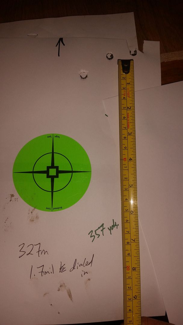

Here is a target I used a both days. The hits at the top and bottom are at 327m before and after I dialed in 1.7 mils. That was how I trued my data which seemed bang on.
Now when I dialed in 1.7 mils today I got this at the same 327 meters.
I was off quite a bit. About 4.2" high.

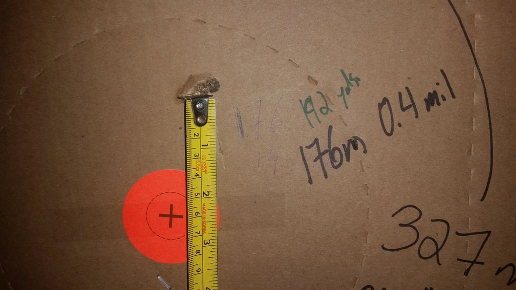

I tried at 176 meters with 0.4 mils dialed in to see what was up. Again I was really high, about 2.5".

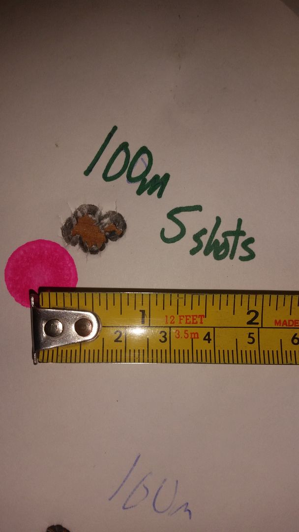

Now I thought maybe my zero was way off but I checked at 100m and got this five shot group:
It was about 0.15 mils high and 0.15 mils right. Pretty close (and as a side note I think it's the best five shot group I ever fired. About 0.3".)
