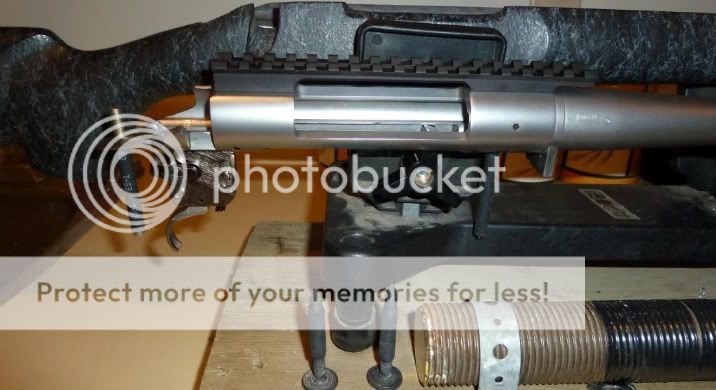

I got this rifle, used, a few years ago.
Took a look at the bedding job and this is what it looks like. I'm thinking it could be a lot better?
Should I strip this out and start from scratch?
BTW it's a Remington 700P. Not looking to spend a ton of money getting a new stock. Just debating whether I can improve this one.
The rifle consistently shoots Sub-MOA with hand-loads as it is, but I'd like to try and squeeze a little more out of her.
It has a full length aluminum bed ... you dont need a new stock. If that bedding that is in there is hard and the gun shoots your probably ok but ... it is a pathetic attempt at bedding thats for sure.
Disregard last comment ... That looks like sh*t ! redo !
The front lugg is not bedded at all :/
What's the big deal? chip it down to the aluminum, rought it up, and bed that #####.
But, honestly, it "The rifle consistently shoots Sub-MOA with hand-loads as it is, but I'd like to try and squeeze a little more out of her. " is true, leave it and shoot the snot out of it. Few can shoot better than that positionally, and few can do it at range once the wind picks up.
Once you wear the barrel out, the smith will rebed when installing the new barrel.

Seems to me that if this isn't what most would consider a proper bedding job, then it is probably worth re-doing. I guess what I'm looking for are opinions of whether I'm being too picky, or is this bedding job actually crap, as I suspect it is.
If the rifle is shooting well then it doesn't have bedding issues per se but that is a pretty terrible job. It could do no harm to redo it properly that's for sure.

Although very good ,Those HS stocks with the full aluminum bed can be awfully twisted from the factory and need to be bedded properly.
I would rebed that rifle. Get the front lug bedded and maybe go an inch up the barrel aswell. Because there is no bedding in the area where the front lug sits or under the chamber ... i dont think that bedding is doing much for you.

Rebed and don't use the rod that came with cleaning kit in the background (have a look at Tipton carbon fibre or Dewey coated 1 piece rod) or the good you do with the bedding you may undo with cleaning.
Redo. That looks terrible. You can do better. If you haven't done it before, read up, its not that hard and will look loads better.

Well, most done. Just some final sanding to pretty it up a bit. It's still not as pretty as some I've seen, but the bedding surface is a heck of a lot better. I'm glad I did it. A few good lessons learned that will make my custom build a lot smoother.
