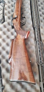

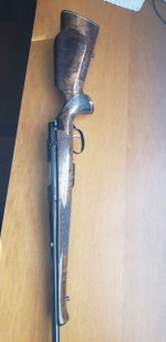

Any stripper should work just fine if you stay away from the eco versions. Work on one or two long pieces of foil. Shiny side up. Paint the stripper on heavy with a brush doing 1/3 to 1/2:the stock per strip. This will keep things from drying out. Wrap stock up in the foil and let sit 5 minutes. Unroll foil and go at it with 4x4" pieces of the green scrubby pads or softer steel wool working with the grain. Use a stiff bristles toothbrush on the checkered. A 1.5" plastic scraper will come in handy. Work fairly quickly. You aren't aiming for perfection here. It'll probably take 2-3 stripper applications on each area of the stock and you probably won't get everything.
An old towel, dampened is great for wiping the stock down well after stripping. Let it dry for a day or 2 and start the sanding process starting with160-200 down to 400. Dont apply so much pressure that you create runways by taking off too much wood. You'll develop your own methods. There will be some darker areas on stock where the old finish has gone deeper but just keep working the "area" until they're gone. Then thd fun begins and you can take that stock as far as you want to go. Anything from a satin to gloss to mirror finish. All depends on how professional you want it to look. If you only want to do the oil and slurry process once every 2 weeks and enjoy handrubbing oil into the stock for an hour at a time choose BOL. I started there but will likely never return. Used to go through 4-5 45 minute sand/slurry/handrub per stock but 12 is the norm now. Like I say it's up to you how professional you want the stock to end up. I've seen guys proud of what some of us would call abominations but to each his own. A couple of finished samples attached. Both were badly beat up when I got them.

That is gorgeous.
I might dig out a rifle just to try something with hand rubbed oil.
