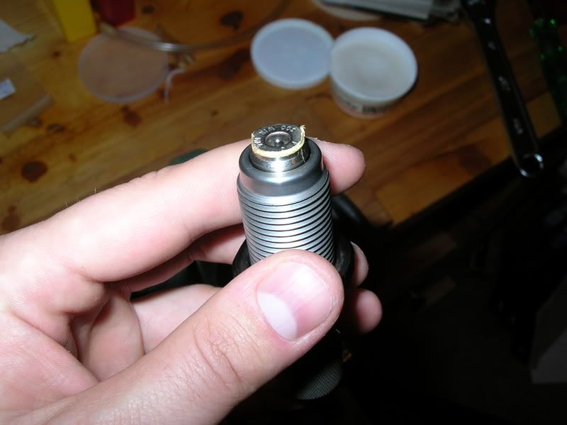

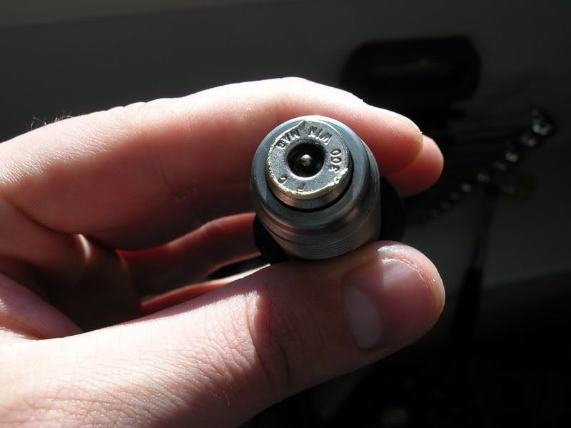

So I was sitting here, merrily rockchucking some 300 WM cases when it happened. *THUNK* the rim tore off one of my cases. :runaway: After a few short minutes of cussing and yelling (BUM Reloading Tip #1: Handload when no one else is home) I did what any self-respecting gunnut would do...grabbed the digital camera to document my plight. :D Well friends and neighbours, the internet ain't real fast at mi casa, so by the tiem I had the photos downloaded to my machine and started the Photobucket upload, I was at a loss for things to do so I started tearing into the afflicted sizing die.
I unscrewed the seating stem and removed all those wonderful bits, then set to trying to get the case out of the die.
Let me tell you...stuck is stuck. But I wanted the case as a reloading memento so I kept at it, bigging out my BFH and pounding on the decapping rod until the case popped free. SUCCESS!!! :dancingbanana: Well, not yet. I still had to get the decapping rod out of the case. Chopping the case in half would have destroyed my memento, so I used what little rim was left, clamped the pliers on the abused decapping rod and hooked the rim into the shell holder. With a bit of fiddling around the expander ball popped out of the case.
SUCCESS!!! :dancingbanana: Well, sort of. My exuberent pounding had peened over the end of the decapping rod, so reassembly would be difficult. What to do, what to do. EUREKA!!! I unthreaded the expander ball and slid the nut and such onto the the rod from the pointy end. The rod's still straight, decapping pin still kosher and she all went back together in the time it took for Photobucket to upload the pics for the story. And best of all, it was cheaper than the first alternative I had considered...throwing the whole s**ttaree away and ordering a new set of dies and brass from He-Whose-Name-Shall-Not-Be-Mentionned. Sorry bud.

I had this problem only with my 30-06 dies, not with my .257 or .303, solved it by lubricating the snot out of my cases, but maybe you are already doing that. Life's a bummer when this happens and you are a long way from replacement parts, but then it could be worse, you could live in the big city and be close to replacement parts. Go out and look at the Northern Lights with your significant other and mellow out.

Okay, okay... When it gets stuck, it gets STUCK!!! Anyhow... Here is a trick for next time...
You got a torch??? If so, good, if not, your stove will work... Your gonna need parafin wax, the stuff that your mom used to bottle stuff with...
WITH GLOVES ON... and pliers ready... heat the a$$ end of that case and touch the parafin wax to the hot case end... Parafin will seep through and allow you to pull the stuck case out...

I've ripped the rims off a bunch, 'til one day I broke down and bought the RCBS "Stuck Case Remover". I've never had to use it.
Buy yourself a "Stuck Case Remover" and you'll never have another stuck case.
What brand of die is it?
If it,s a Lee, you can still loosen the decapping rod's collet and pound on it with a hammer and the case will pop out.
With other dies, you can try unscrewing the center holding nut, finish unscrewing it from the rod and try tapping on the decapping rod.

I did that to an RCBS die a few years back, I bent the rod. I sent an email to RCBS, and a few days later, a new rod showed up, with a few decapping pins, all free of charge.

its an esay problem to solve..unlock the decapper..screw it all the way down now use the locking nut to push it the rest of the way down.. should work easy as can be..

Redding Imperial sizing wax will prevent this as Splatter mentioned so will a stuck case remover.

I ended up making a stuck case remover consisting of a drill bit, tap, bolt and a stack of washers - not quite as handy as the RCBS unit, but it works slick. I'll have to try the parafin trick though - that sounds interesting.
Hehehe, I've found the 20 ton shop press to come in handy on more than one occasion. A bench vise, vice grips and a rubber mallet are also useful tools that everyone should have in their garage. And a torch can help ease things along, too.
One trick I've used in the past is to clamp the die down is a bench vise, and clamp the protruding end of the brass real solidly in the vice grips. then whack the grips solidly with the mallet as close to the die as you can. Most the time one or two good 'thwacks' is all it takes.
