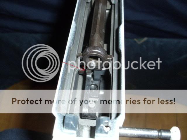

FWIW, here's a pic of the bolt from the magwell.

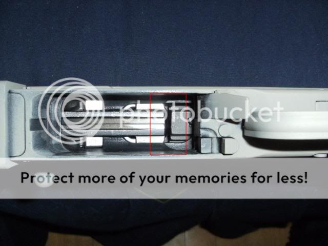

Based on your pic I think I know what your issue is. The striker is cocked to the rear, which will make it so you can not remove the rear cover.
1) In the red box you can see the striker. In this position the rear cover can be removed.
2) In the red box you can not see the striker. The striker is to the rear and the springs under tension. In this position the rear cover can not be removed. (Same as pic you posted above)
3) With the striker to the rear the lower spring guide ( 1 ) is inside of the striker ( 2 ) which is why you can not lift the rear cover
4) You need to release the striker into the forward position to remove the rear cover. The red box is the sear (CZ calls it the striker catch). The blue box is the sear spring ( CZ calls it the trigger unit spring). You need to pull down on the sear (striker catch) until the spring tension pushes the striker to the forward position.
You should now be able to remove the rear cover, if there are no other issues.

I was just cleaning the trigger mech on my CZ and didn't push the pin retaining clip all the way down. Guess what happened... the striker got stuck in the rear position. It got hung up on the part above the safety pin. Fortunately I had the dust cover off and was confirming that I had everything back in place.
So... it is possible for the pin retaining clip to hold the striker back. Another thing for you to check.
I really hope it is not that. I have no idea how to fix that, short of drilling a hole in the rear cover big enough to get a tool in there to push the retaining pin down.
1) Retaining pin in proper location
2) Retaining pin in call a gunsmith position
Let us know how you fix this, if this is the problem. Defiantly very important info to know.
