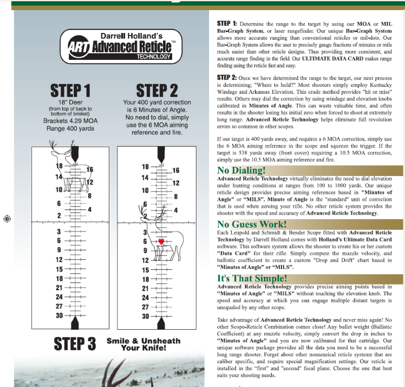

If someone have a pictorial from Leupold brochure or anything I would appreciate it
About a decade and a half ago, there was a reticle range finding system applied to some Leupold (and S&B) scopes called Advanced Reticle Technology. It was available through Holland Shooters. (Google it for a pdf.) It may be similar to what you have.
the info used to be part of every Leupold owners manual that came with each scope including basic duplex
I'm sure those are available
Heres one for their various ballistic reticles
cdnp.leupold.com/products/productDownloads/ballistic-aiming-system-manual.pdf
Crank the power ring until you bracket a deer sized animal’s body between the main and bottom heavy bar of the Duplex reticle, then read the range off the range scale. Is it exact? Hell no. Is it closer than most people can guess? Hell yeah. Reticle subtension has been used for range estimation since forever and this is just another way of doing it. Heck; its not hard to find fans of mildot reticles for ranging and that involves math that the typical user can’t even do. You can even use a bead front sight for a rangefinder if you give it some thought.😂
A shortcut with the Duplex is to sight in a rifle that can support a 300 yard MPBR. Thats just about everything worth shooting. When confronted a longer shot crank your scope to max power and if you can touch the deers body with the top and bottom heavy bars you might as well pull the trigger because it’s inside 300. If you can’t, its past 300 and you have to start making some decisions.
