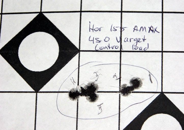

Yesterday, I shot my "control load" at 200. This is my standard load for this rifle and barrel: 45.0 grains Varget, in a Federal case, ignited by a 210M, pushing a 155 AMAX, seated to 2.810". I was planning to experiment with some new bullets, as well as try some different charges of Vihtavuori N550. By the time I fired the control load, the wind was gusting a bit, but I shot through it without concern. I simply fired the string, bang, bang, bang, bang, bang, without looking through the spotting scope or making any windage corrections. I had a friend spot my target while I was shooting, and he noted about halfway through the string that the wind had dropped off.
Anyway, here is that 200 metre group, with the shots numbered in the order they were fired. The moment that the breeze let off is immediately apparent:
The breeze was mainly visible in the form of a light rustling of the leaves on the right side of the range. It was also apparent in the mirage through the spotting scope. As you can see, even this subtle breeze had a half-minute effect on the shots. If I didn't realize all this, I might conclude this was a mediocre load just by measuring the group size. The entire string measures a shade less than 1.5 inches, which translates into 3/4 moa -- pretty crappy for this rifle.
As a result of this lesson, I fired my N550 test loads at 100 metres. I guess there is a lot of wisdom in the standard practice of doing load testing at 100, and I stand humbled. :redface:
Nothing wrong with that group when shooting in the wind. I always figure the best groups are the ones with the least elevation stringing. Almost every shot in the group touches the horz line, so I would have to say it is a good load. The height of your group is about what 1/2" or less at 200m?
You can't control the wind so you have to read it, but only if you want to put them in the center of the target. If you are just shooting groups to develope loads, I wouldn't worry about horz strings as much as vertical.
Now if that was a vertical group, that's another story.

Certainly Tom’s point is very relevant. Your group(s) is not showing much vertical. Load it and shoot it. You’ve got more to learn (possible loose) from reading the wind/mirage than problems with that load your showing here.

Improving this load further might be counterproductive to simply shooting it under match conditions. At this point you’d loose more points from a missed wind call.

I wouldn't worry about the load, as the weather report is obvious, and the two that are stray are still inside the vertical string of the rest .
